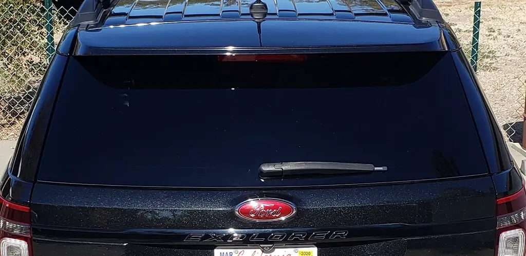

Before photo:
First is taking the wiper off, pretty straight forward. Just undo the nut on the stud and I used some VERY light taps of a small ballpeen hammer on the end of the stud to break loose the pressed-on wiper mount. Gotta be careful so you don't break your glass, LOL.

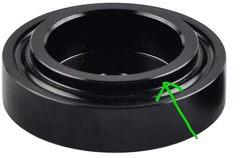

So this portion of the exterior part of the block-off fits nicely inside the hole in the rear window:

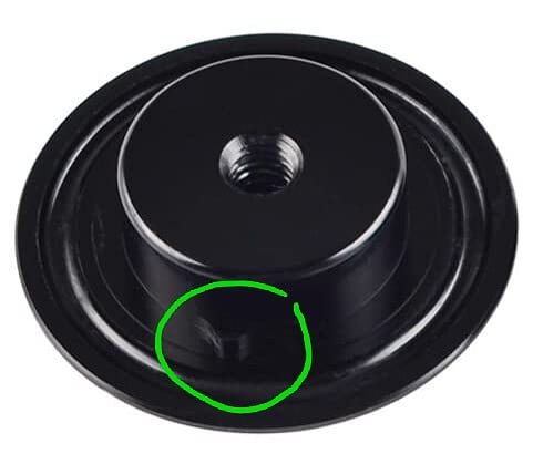

However there is a small triangular tab near the base that is a notch meant for the rear window of the Civic it is originally designed for:
WARNING: If you do not remove this notch, you WILL shatter your glass as it will put pressure on it, since our vehicles don't have that notch. You will have to grind it off. I used a dremel for this.

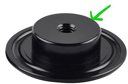

On the interior portion of the block off plate, this raised portion of the part will hit the inside of the window before the o-ring will, so either you won't get a good seal or, if you crank it too hard, may also break the window. I used a lathe to turn it down flush with the rest of the body of the plate, but a dremel will work fine as well:

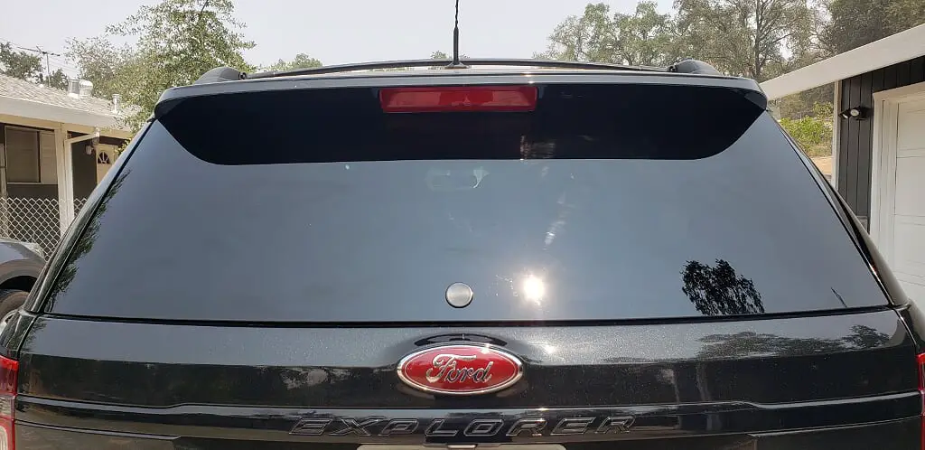

After photo:
Anyway, love the look. We don't get much rain here, so I never used it. Not to mention, my rig is not a daily driver, so removing it wasn't much of a concern. Not for everyone, I'm sure.
