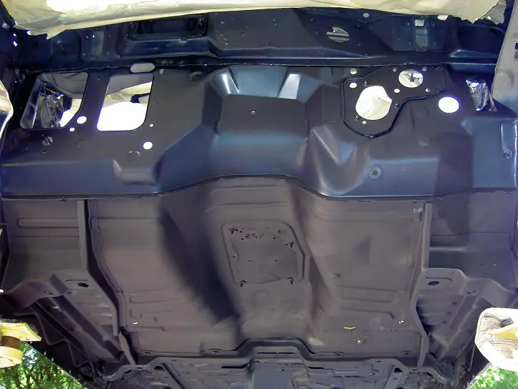

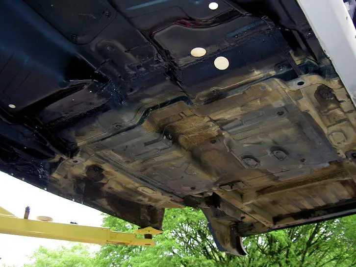

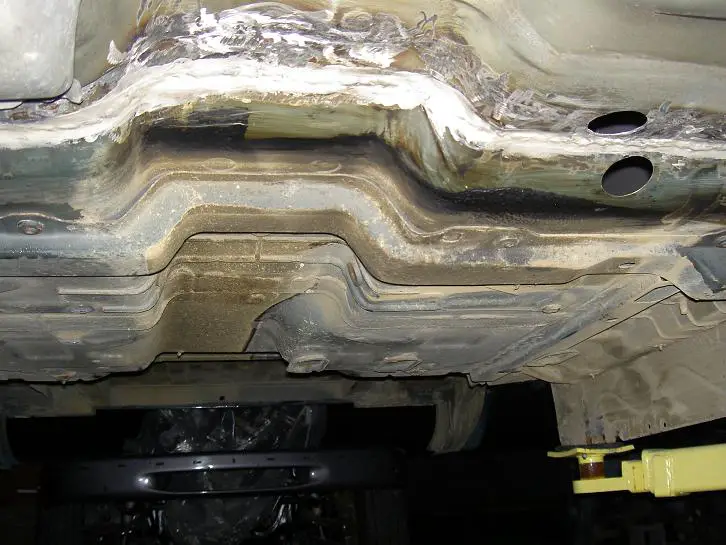

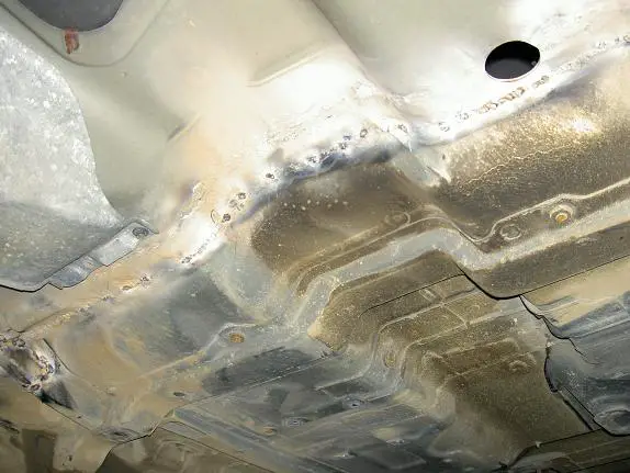

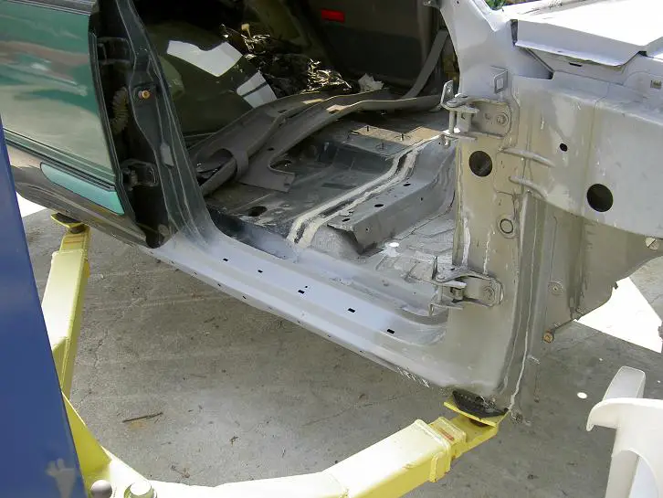

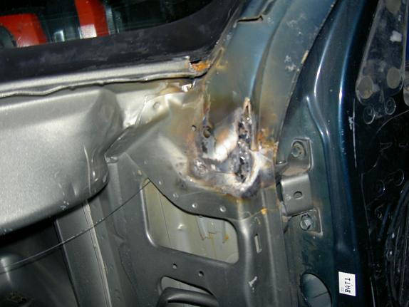

I have been having big computer troubles for a while. Here are two recent pictures, after the welding, and the painting of the clip. Regards,

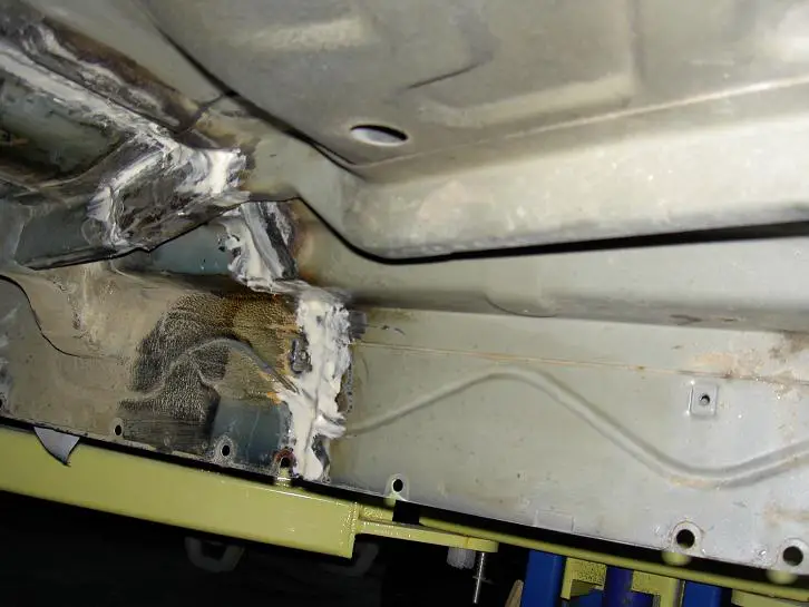

what is the white body putty you used? I ask because I am doing some rust repairs and will be needing some......the OEM stuff I knocked out was still pliable after 287K miles and 18 years.....
Seam sealer, this was 3M brand. My body man was dissappointed that the thick/coarse rock guard isn't available any longer. He is used to spraying that over clip welds, completely hiding the repairs.
For rust repairs, the liquid which I used on all of my rust areas seems very very promising. It is an old product which I bought as a gallon, called OxySolv. It is like water, and flows/creeps into seams far far better than any rust converter product. I used Eastwood's Rust Encapsulator over that, and on my frame. Time will tell of course, but the thin liquid seems like the best solution for killing old rust. Good luck,

Thanks for the thoughts all. I got a bunch of the paint work done today. The fenders and door jambs are painted, as well as the header panel, grille, bottom of the hood, door handles, cowl, radiator support, etc. Basically all the body work that is left is the hood painting, front bumper, and fender flares, etc.
I'll get pictures taken as I go along. I need to get the body and chassis bolted together, to get it off of the lift. Doing the wiring and reassembly will be my final tasks. Regards,

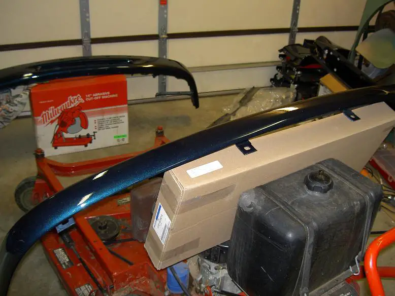

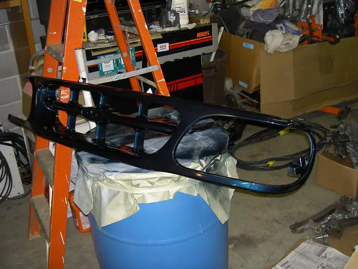

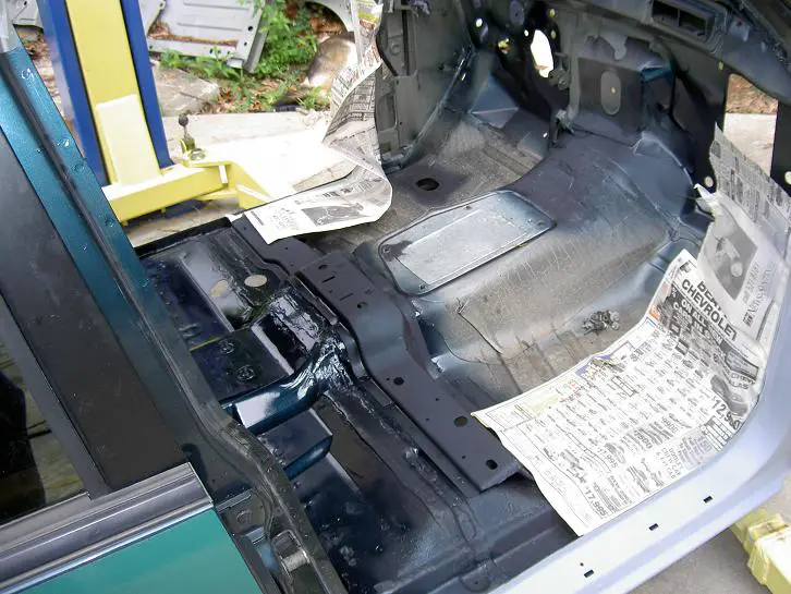

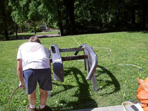

A few more recent painting pictures, I only lack the hood to be repainted. As soon as we started spraying the hood, a swarm of termites came through for twenty minutes. I got 21 parts painted Tuesday, and the hood was first, and must be sanded again, etc. Regards,

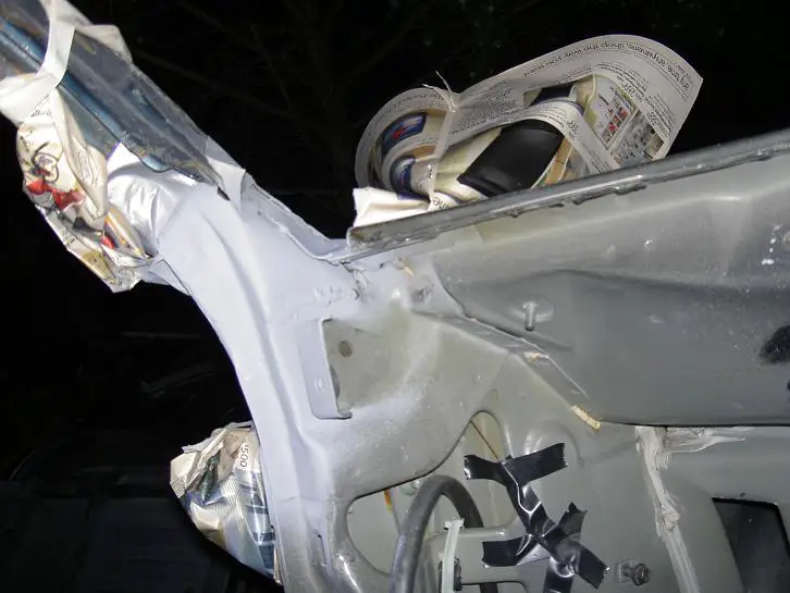

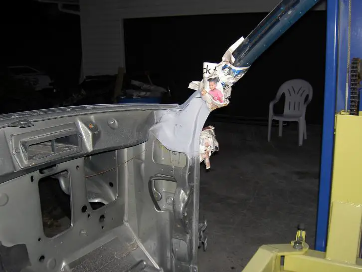

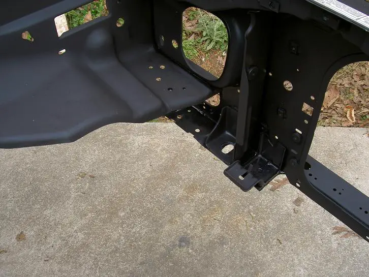

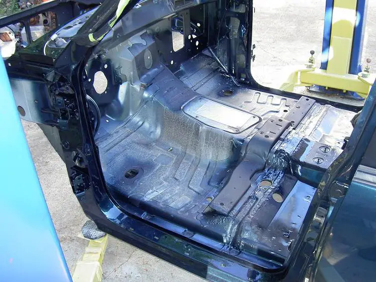

I also painted the 99 clip, and undercoated the whole underside.

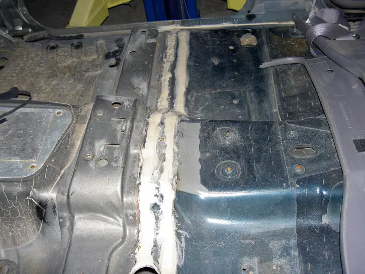

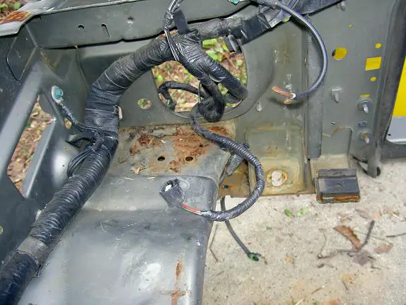

I don't think I had posted the body work on the clip.
