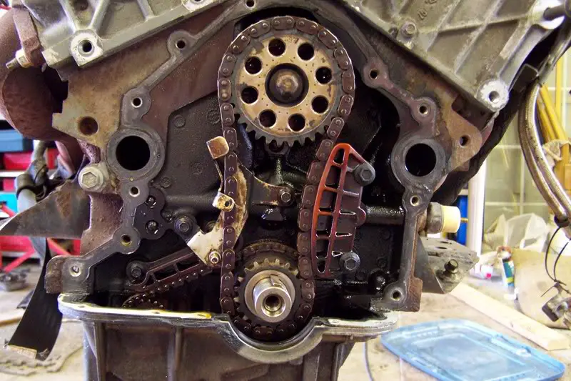

A google search of this topic, others that have had this problem a few reported it was an oil galley plug.

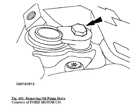

2. Were you careful to engage the shaft that links the oil pump to the drive gear assembly in top rear of the block? I seem to recall that it is possible to reassemble the engine with the shaft not engaged at each end. Since there is some oil pressure the pump is actually rotating but possibly not at full speed. There is a spiral gear on the rear of the jackshaft that drives a small assembly. I think that you can check by removing the drive assembly hold down cover bolt.
Be very careful when removing the drive as if the shaft comes up with the drive it may be difficult to align correctly to re-engage the oil pump.

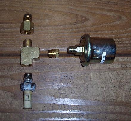

3. I've learned that pieces of cassette guides can end up in the oil passage that goes to the oil pressure switch. As I recall anything above 5 psi to the switch results in a midrange oil pressure indication on the "gauge". Where did you measure the oil pressure to be 5 psi at idle and 30 psi at 3K rpm? Did you remove the oil pressure switch and connect a mechanical gauge to the port? If the path to the switch is blocked you may be able to clear the block with a wire after removing the switch.
The primary chain plastic guide covers an opening in the "tube" that goes to the oil pressure switch. I know of a least one Forum member that found a piece of a cassette in that tube.

2. I tried to be as careful as I could with this part. Its a little tricky to be sure both parts are engaged when bolting it back on. I did prime the new pump so it was easy to spin with my fingers. When I bolted it on, I was not able to rotate it and it didn't look like it was seated improperly. I am very hopeful that this would not be the cause.
3. I have removed the oil pressure switch and inspected its hole, but I didn't see anything in there. I had this thing nearly completely apart, short of taking the pistons out. I really tried to do a thorough job of making sure there were not any loose parts anywhere in there. I had it rotated a few times over on the stand as well and nothing was falling out. That said, I am not super familiar with the oil path and I suppose it is possible something could be lodged somewhere. I just find this hard to believe though as well because of how much I went through it. Also, it was the cassette on the drive shaft to jack shaft chain that broke, so just about all of that would have fallen straight into the pan. There were a few pieces of plastic near the cam shaft, but not much.

You didn't answer my question about measuring the oil pressure. I'm not familiar with the Sport Trac but if its like my Sport the oil pressure "gauge" on the instrument cluster is just a glorified idiot light. It is activated by the oil pressure switch reading mid-range when the oil pressure is greater than 5 psi and low when the oil pressure is less than 5 psi. I added an oil pressure sensor that drives an actual oil pressure indicator. I chose to retain the stock pressure switch so the oil "pressure gauge" on the instrument panel would continue to function. I installed a "T" for the stock oil pressure switch and an aftermarket oil pressure sensor.
The electrical output goes to an indicator installed in an A pillar pod.

I hooked up an actual pressure gauge where the sending unit goes.

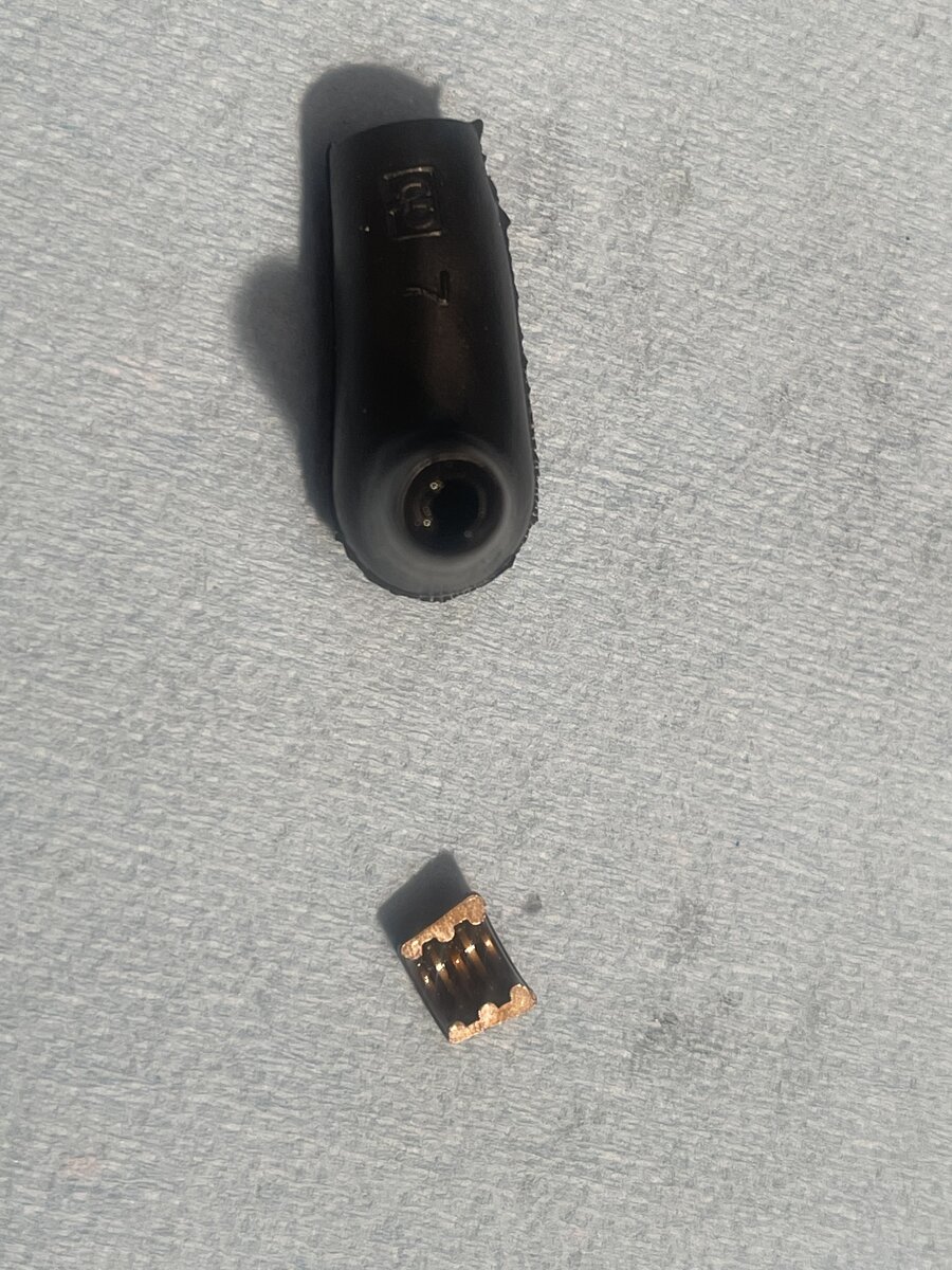

I finally had some time to look at a few things today and I must say, it has been a very bad day.
First, I noticed a broken wire for my knock sensor. I’m not too familiar with a knock sensor and certainly don’t know if a non working one can cause all of the problems I was experiencing. So, I purchased one and decided to put it on.

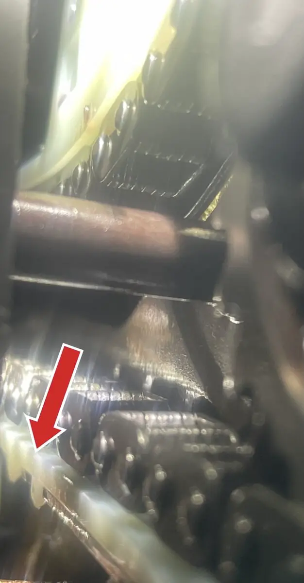

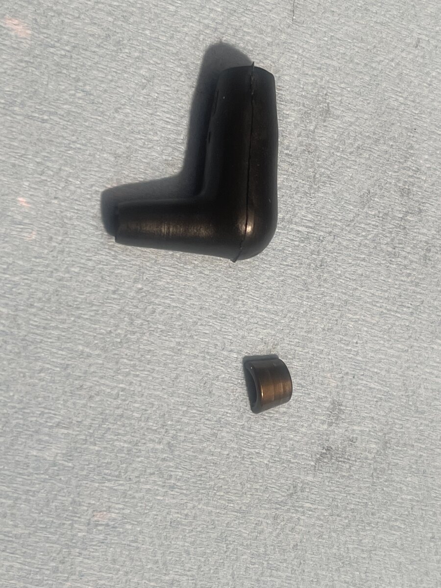

Since this required removing the intake manifold, I decided I would pop off the driver side camshaft cover, since that’s where most of the noise I heard was coming from. First thing I noticed was one small piece of broken metal and a small rubber elbow. Nothing appeared broken with the cam shafts system, but I have no idea where either of these items came from. You may notice a small number 7 on the inside of the rubber elbow.
I also inspected the the front cam timing chain and while it still has tension and appears to largely be ok, I also noticed a small plastic piece had already broken. What’s crazy to me is I located where it came from and there shouldn’t be anything rubbing it to cause it to break off.
I’m beginning to think this engine may be toast and I’m very sad about it.

That's a rubber vacuum connector
Someone must have dropped it in there
The metal piece is a Valve Spring Retainer Keeper
Find the valve that's missing one
Not good
