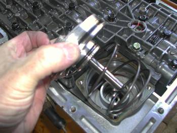

I lost reverse a few months back, then went through all the steps mentioned here-I installed a rebuilt valve body (with new EPC, other solenoids tested), and then replaced the reverse servo piston. I can see that there is a mark on the band itself when I look into the bore-it looks exactly like the tip of the piston-kind of cratered. Installed new D rings.
