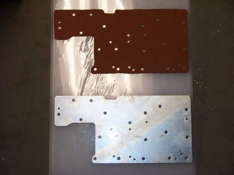

Do you have the gasket between the pump and case installed? maybe it mispositioned...

You mean the round one that goes on the thin plate between the pump and case? Looks like a ring with no holes?
I am referring to the paper gasket that sits on the thin metal plate, it seals the oil passages to and from the pump.
Yes I got that one on and all lined up I'm pretty sure there's only one way it lines up. This thing has been very frustrating but I have to take it out again anyway. Is there any other seals I should check? I replaced the center support and all the lip seals in the drums. I still can't figure out the no reverse thing.
