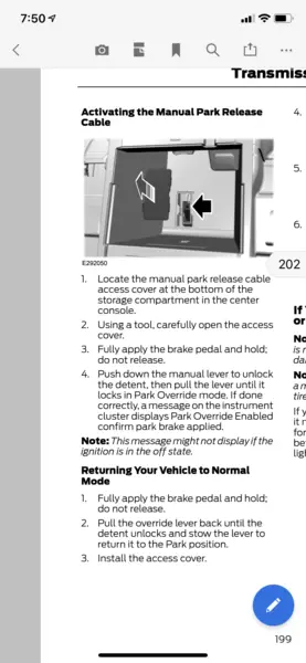

I've not gotten any notification of it. Where is the manual park release located so I can check to see if there's a cover?

Bottom of the center console, under a thin mat. Either has a cover or doesn’t. Per manual:

That seems to the same as the 5th gen. Brake Shift Interlock.

All good here. Cover in place. Instrument cluster ok too.
