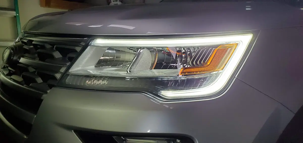

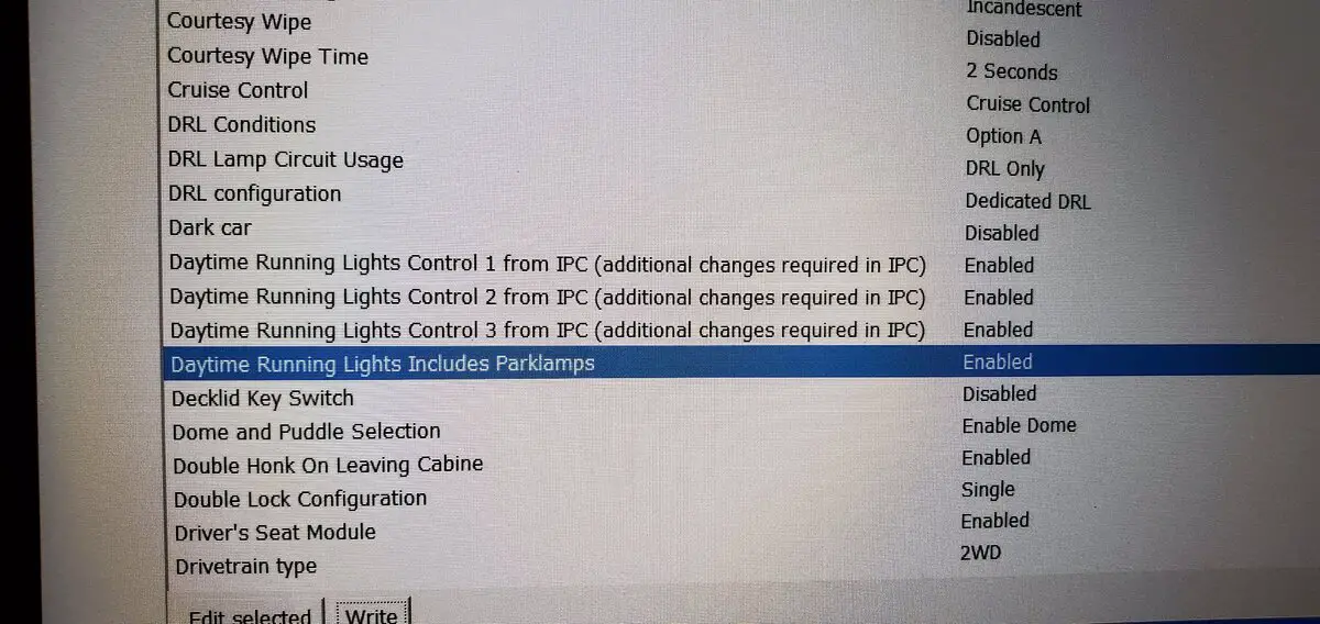

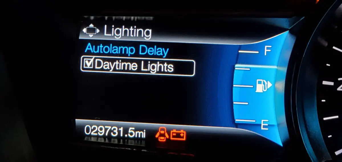

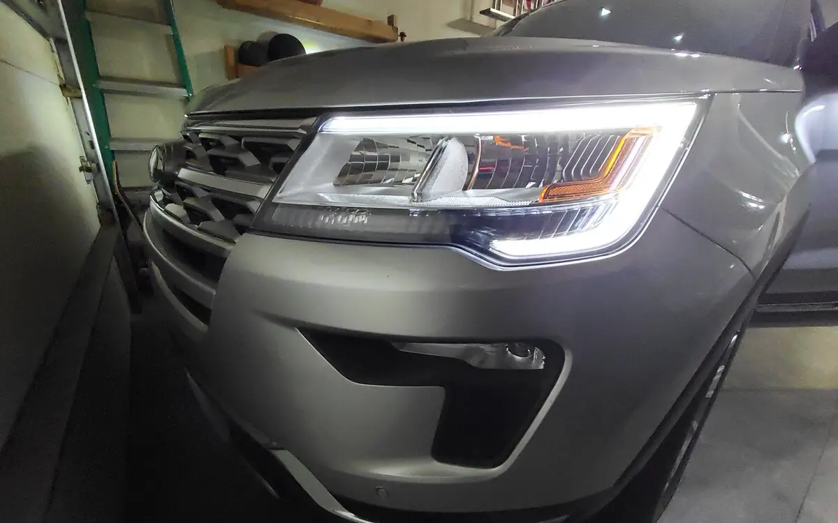

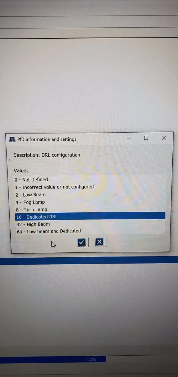

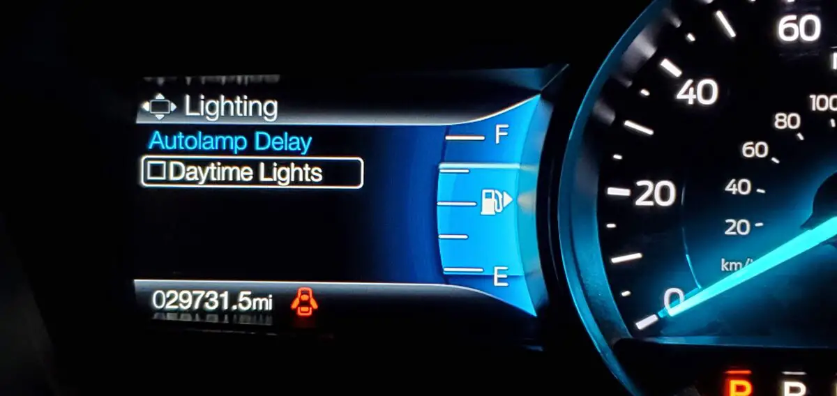

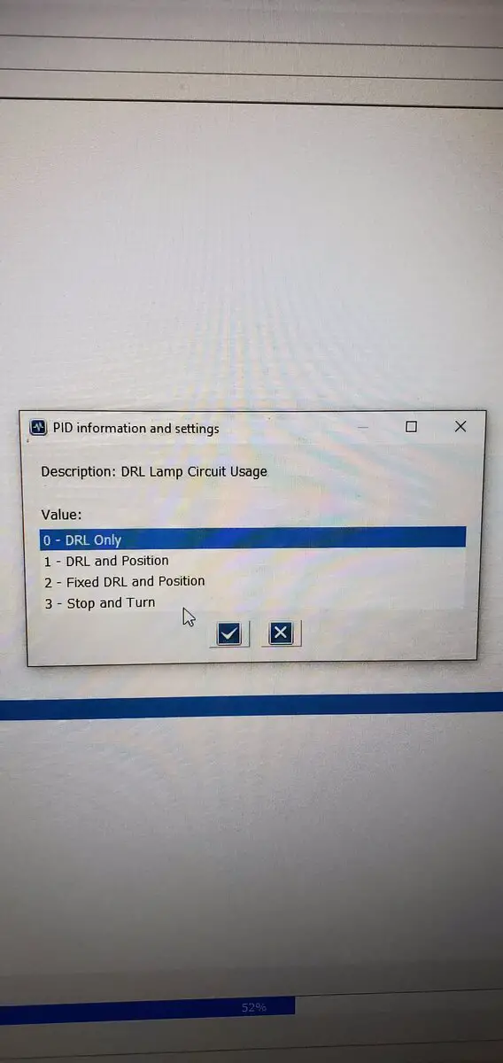

I did accomplish what I wanted to do, by using the easy mode and changing a few parameters of the DRL's in Forscan. Thankfully without the need to change or mess with As Built Data! 😁😎
Here's the Settings I had to change, and also Enable. Which then highlighted Daytime Lights in the left IPC and allowed me to Check/Uncheck it to disable my LowBeams while driving in the daytime and only use the Halo's!

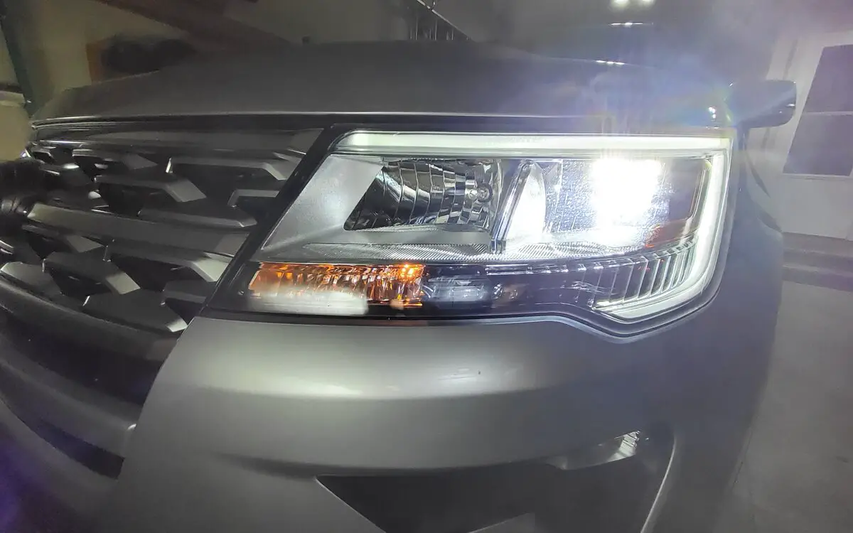

While shining my bright led flashlight and having the EX in D, the lowbeams went off as desired. Same when I pulled it out into the driveway.

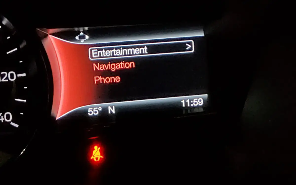

Finally, glad to have this done and figured out, as well as having the Temp Display in the Right IPC as well...

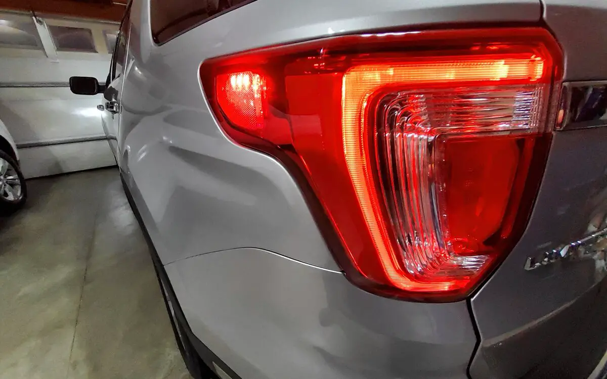

Glad you were able to get it to work. Looks like your turn signal run lights are now disabled though?
Also what was your lamp circuit usage set at before you changed it to DRL only?
Turn signals only came on with Halos during Remote Start function. Turn signals weren't always active previously while driving in the daylight, only my Halo & LowBeams.
I believe #2 Fixed DRL and Position. Could of been #1 I don't really recall, I did do a save prior to any changes though.
Really? Interesting.
Did you also enable park lamps with DRL? Because that should turn on your front side marker lights and your tail lights I believe.
No, I only wanted Halos during daytime. As sun goes down, everything else comes on as intended in Auto.

Very interesting. Does performing these steps make the Halos bright enough to be effective DRL's? I know they are normally not bright enough to be used in that way.
Works for me.
Yes, abut 75% as bright as most new vehicles with led DRL's.
how did you do this
I enabled the option for Temp in IPC(Instrument Panel Cluster) via Forscan in the IPC settings.
