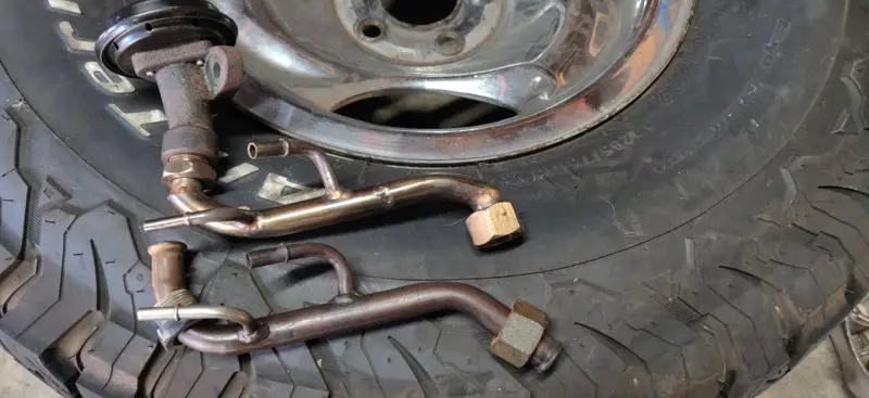

EGR issue are you using the EGR tube that came with the headers?
The gasket between the EGR valve and intake is suspect
AS long as the sample tubes and DPFE are all hooked up properly

the TMH header EGR tube went through a revision, that is why I ask....gotta make sure you have the revised part!!!
Since it's an OBX I don't know if it was revised :dunno:
Interesting
I would use a non OBX supplied EGR tube if you are worried about the EGR system and you are already in there replacing the header gasket

1. Is that the obx egr tube on top of the stock style one?
That OBX tube is funky funky, it looks like they took a dorman tube, hacked it up and welded on new end bits to fit their header??
If that is the case it should work okay, the proper guts are there
there is some sort of restriction or orifice tube inside the EGR sampler tube that is key to the egr performance, I believe the OBX tube has been built properly

Yeah but the EGR tube from OBX is stainless, but it does look really weird up close.

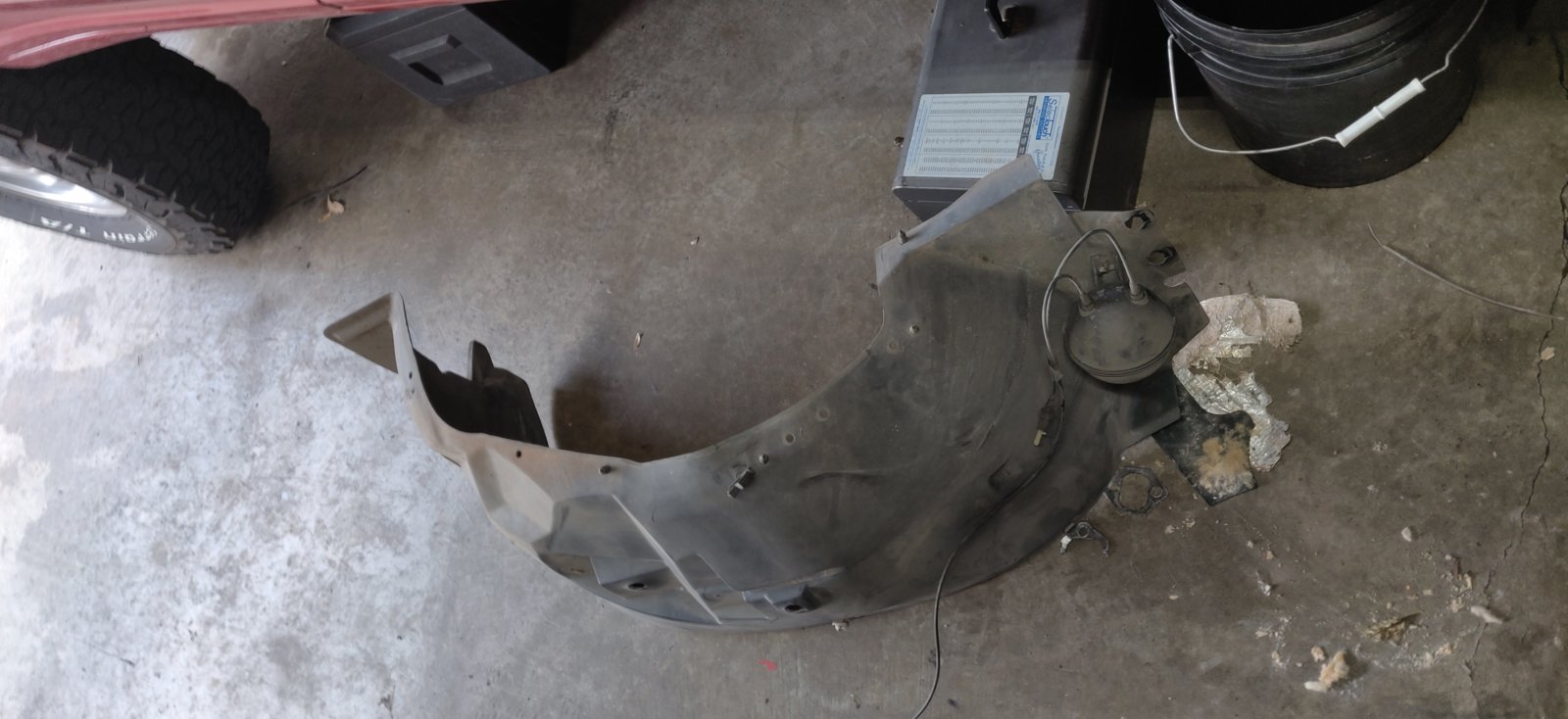

I picked up a fender liner and replacement vac hoses for the passenger side. The fender liner had come out and the tire ripped it up pretty good. Plus I also needed to get the bolts to install the vac globe.

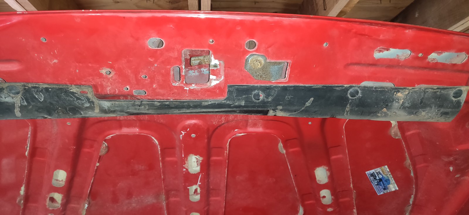

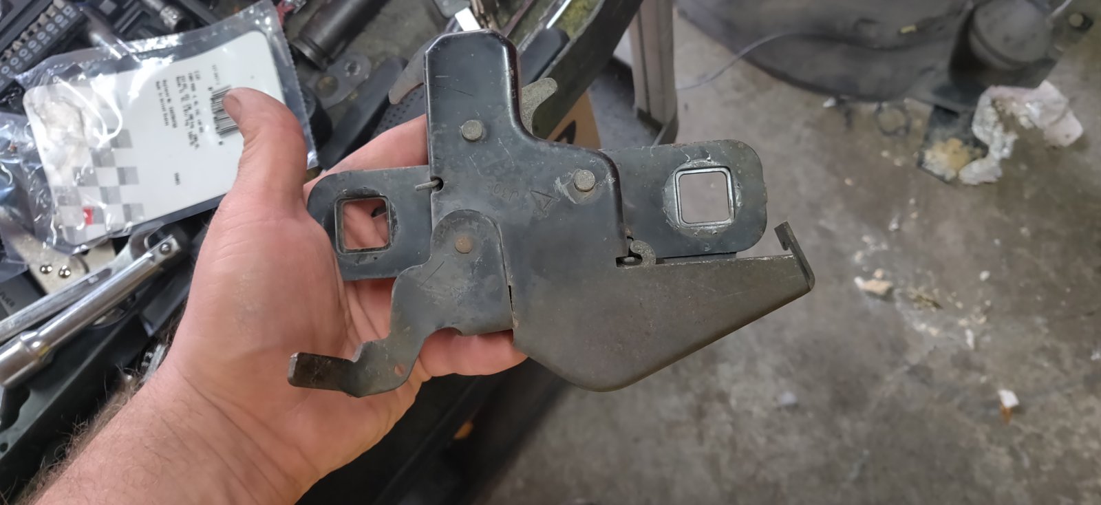

I found out that the part in the hood that the safety latch bolted to had broken off and was nowhere to be found. So I opted to put in a hood latch from a 96 that has the safety latch integrated into it.
See the difference?
98-up
95-97
To go this route you need to replace the latch tab in the hood as well as the latch itself, but it's pretty much plug and play.
The upside, other than keeping my hood from flying up, is I won't be smacking my head into the latch; which was why I removed it in the first place. Why did Ford change their design? :rolleyes:
