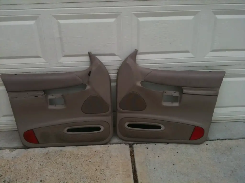

Headed to the junkyard this morning to pick some things up. First is a set of good looking front door panels. These and the rear panels will be recovered in red leather to match the seats sometime next year.
I also tore into a Taurus door panel to get this:
Its a one touch down relay than I plan on wiring into the passenger side window controls.
Not a bad jy run and I got it all for $30
Nice, do u plan on covering the entire panels in leather or parts??
Just the leather part of the panel.
