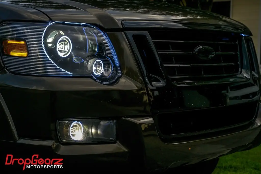

One of my first rebuilds has been my retrofit. I did a quad retrofit in the headlights and a simple retro in the fogs. I have a few alignment quirks to work out when i Heal a little more, standing and crouching in certain positions to do this build was killer on my neck and back. I also work for The RetrofitSource and I am an authorized dealer under DropGearz Motorsports. I'm happy to give any tips and answer any questions. Explorer forum has proved invaluable to me with all of my trucks with the wealth of info. I'm only glad to help.
Removed the factory turn signal and installed Morimoto Matchbox Projectors in their place and Morimoto D2S 3.0 Rounds with Panamera shrouds where my factory headlights were. My foglight were gutted in favor of Morimoto Mini H1 projectors which are in al honesty a little big for the housing and require modification to fit but damn they're bright. All 6 operate as high beams and low beams. Thats right, i installed our "correctional splitter" to keep the fogs from turning off when the high beams are activated.

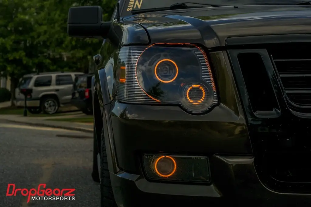

These are the Morimoto XSB Switchback Halos and Strips in the housing, this is how i maintained a turn signal.....or 14 lol. I also laser etched an inverse version of my logo onto the lenses of the projectors.
The next image below shows my turn signals, the factory 194/168 parking light bulb was removed in favor of 3 of the morimoto XSB 3" Switchback strips which I have no deemed to short to fit into that reflector and will be replacing them with 3 of the 6" strips
All 6 projectors on, the HID kits are as follows:
-Headlights: Morimoto D2S XB55 Elite HID System with 5500K Bulbs
- Secondary Headlights: Morimoto XB35 Elite HID System with H1 5500k Bulbs
-Fog lights: Morimoto XB35 Elite HID System with H1 5500k Bulbs
The headlight shrouds will match the fogs very soon, i've already painted new shrouds the exact same Gold.
Just because, I purchased a new third brake light since my other one was cracked in the accident, this one was preferably over the recon simply because i wasn't impressed with the recon cargo lights, i think they're far to dim especially for that price. This one has LED's for the third brake light which are remarkably bright and I installed our Morimoto XB LED T10/194/168 bulbs into the cargo lights and my God they are bright. They're also in my tag lights, and courtesy lights. My interior lights are the Morimoto XB LED 42mm Festoons which are even brighter.
