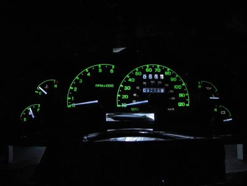

I just finished putting in the LEDs into the cluster heres what It looks like. I am happy with the results. What do you think?

so which ones did you use and from where???

are the as bright or brighter than stock lamps???

They are not quite as bright as the stock bulbs are, but they are far from dim. Its actually easier on you eyes driving at night.
The ones in my first post would by far be brighter then the stock bulbs, but they are expensive.

hey mustang, its weird that your gauges are still green. When I took my bubls out they had this blueish green cover on the bubls. And when I changed my bubls to blue my guage turned blue.

Yea there must be some small changes from 97-01 with the cluster because I had normal 194 bulbs without any green caps on them, the green film must be in the actual gauge faces.

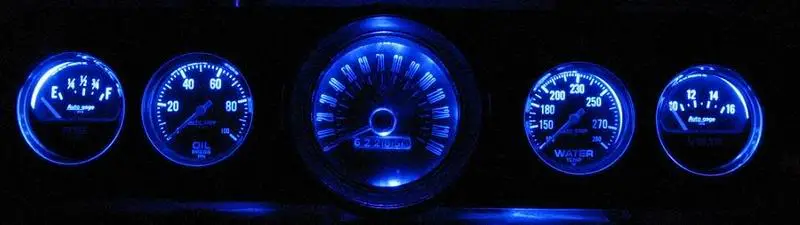

Well just a few days after I fixed the bulb that blew out in the Explorer with LEDs. One of the bulbs blew out in the Mustang's speedometer. Go figure. So I decided to do an LED mod to it as well. For this I had to make a custom LED setup because just putting in the LED replacement bulbs wouldn't light up the gauge evenly, I just drilled holes for 8 LEDs into the back of the speedometer just big enough for 5mm LEDs. Needless to say the other gauges had to match. :) It is much brighter and more evenly lit then the original bulbs.
The hot spot at the bottom of the speedo only appears in pictures for some reason.

That looks very nice. I used to have leds in my neons gauge cluster. They turned out brighter then stock. The cluster shined green just like the explorer one did, i had a few burned out bulbs on one side of the cluster so it was a good project to do while i was pulling the cluster.
