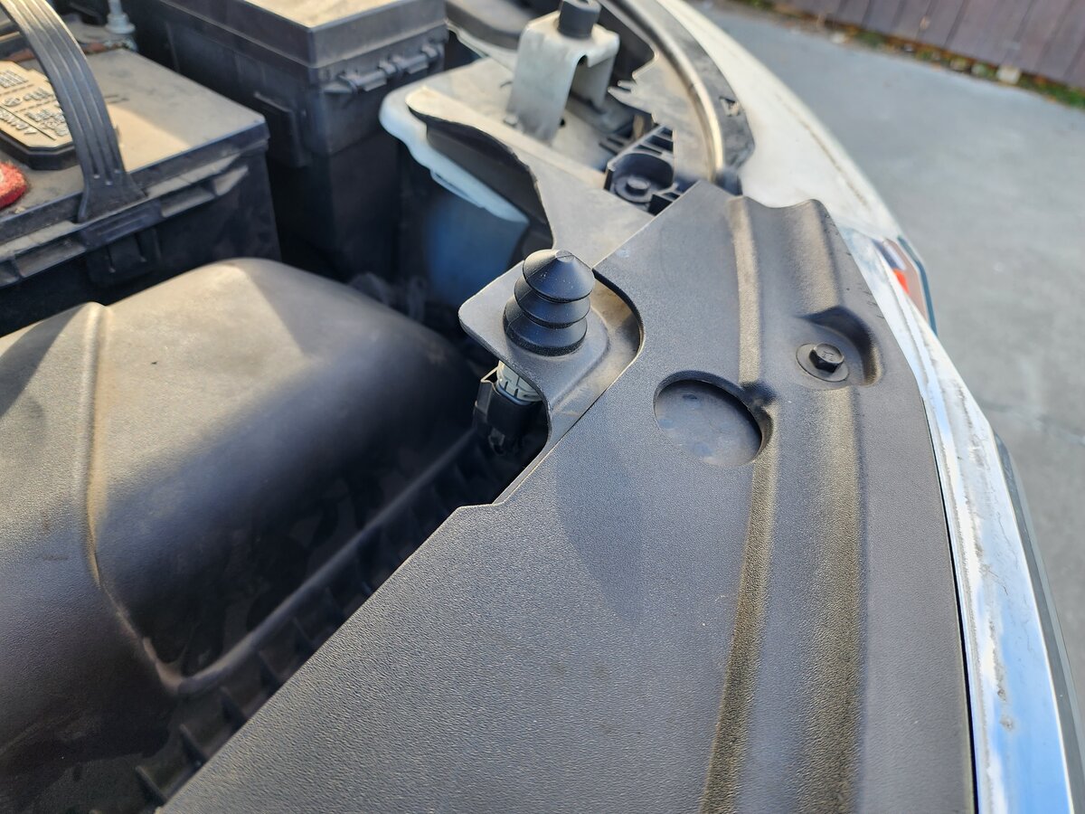

You will need to order a hood switch, the remote start won't work without it. You will also need to use FORScan to enable the remote start. I did this on my PIU and it works just fine! It's super useful right now since it's cold and I can remotely start the car without having to go out to crank it myself. You can order a hood switch from eBay for $10 dollars or so, or you can pull it out of a junked Explorer for almost nothing I'm sure. You also need to make sure your car is wired for remote start underneath the hood. I attached a before and after photo of me installing the hood switch.
You will need to order a hood switch, the remote start won't work without it. You will also need to use FORScan to enable the remote start. I did this on my PIU and it works just fine! It's super useful right now since it's cold and I can remotely start the car without having to go out to crank it myself. You can order a hood switch from eBay for $10 dollars or so, or you can pull it out of a junked Explorer for almost nothing I'm sure. You also need to make sure your car is wired for remote start underneath the hood. I attached a before and after photo of me installing the hood switch.View attachment 436422View attachment 436421
