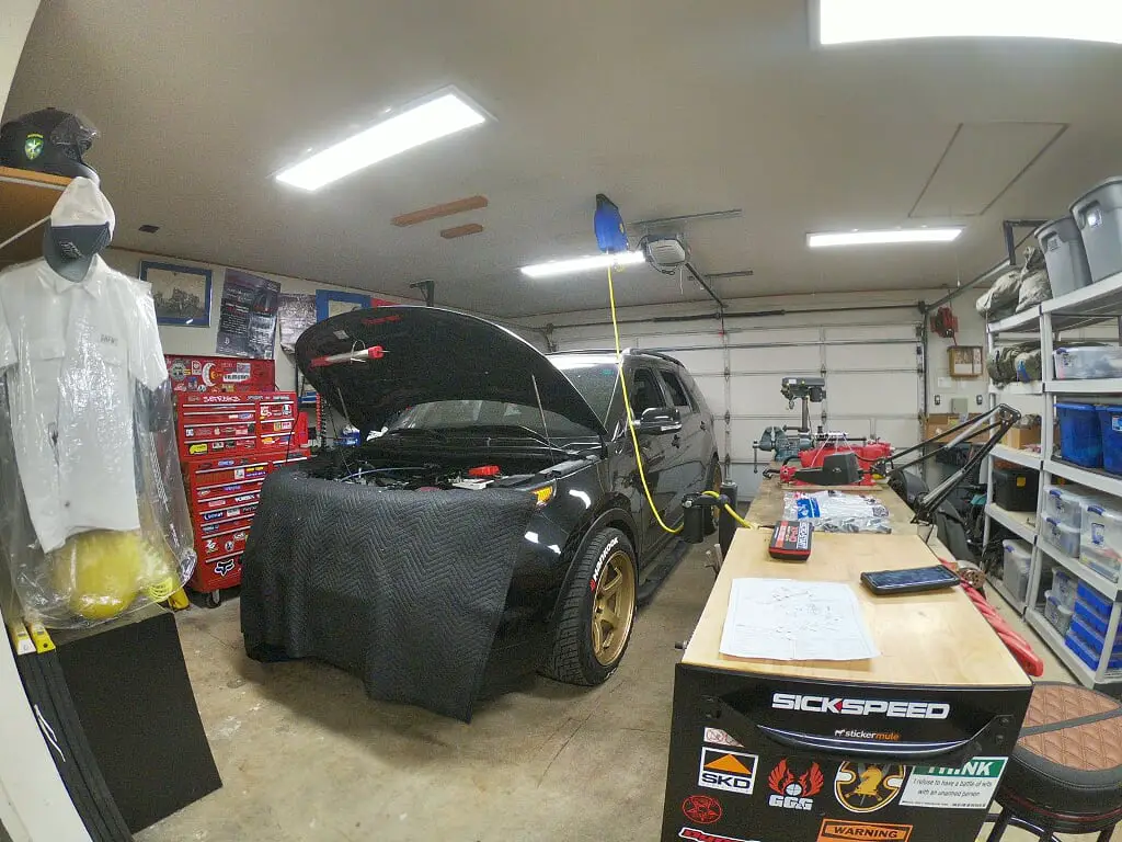

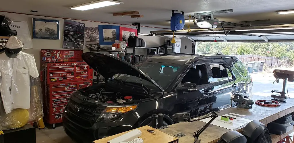

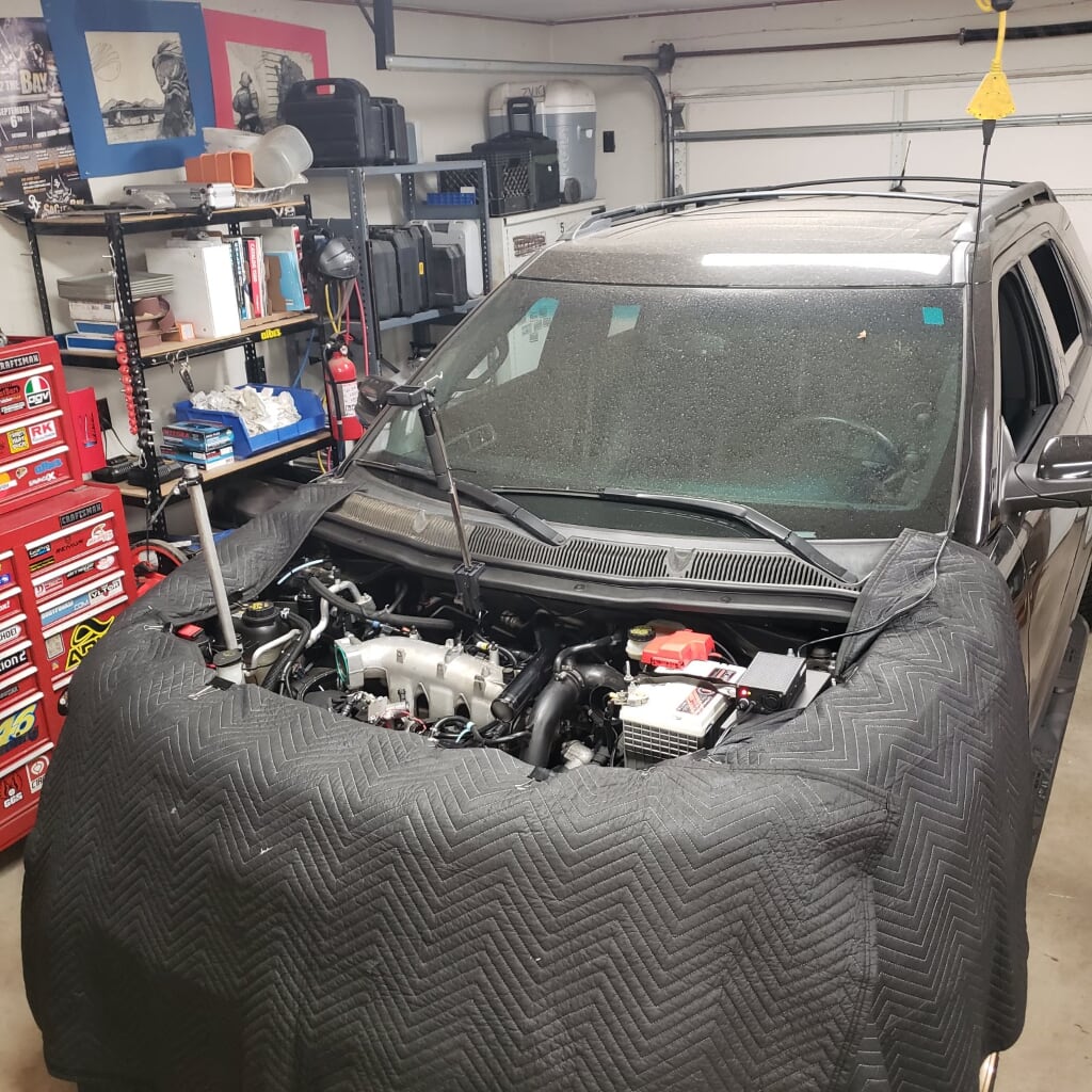

Removal of the hood made it easier to access everything and wasn't hard at all. It only weighs about 20lbs:

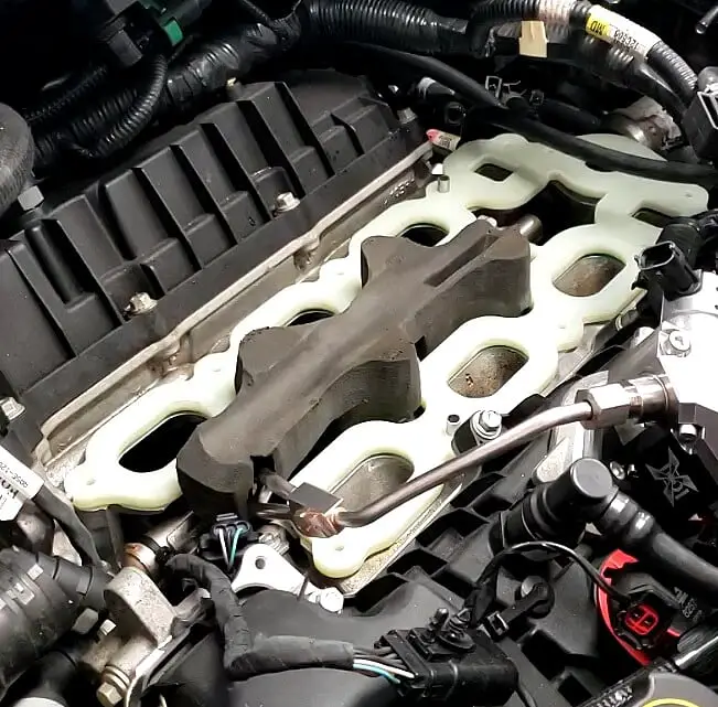

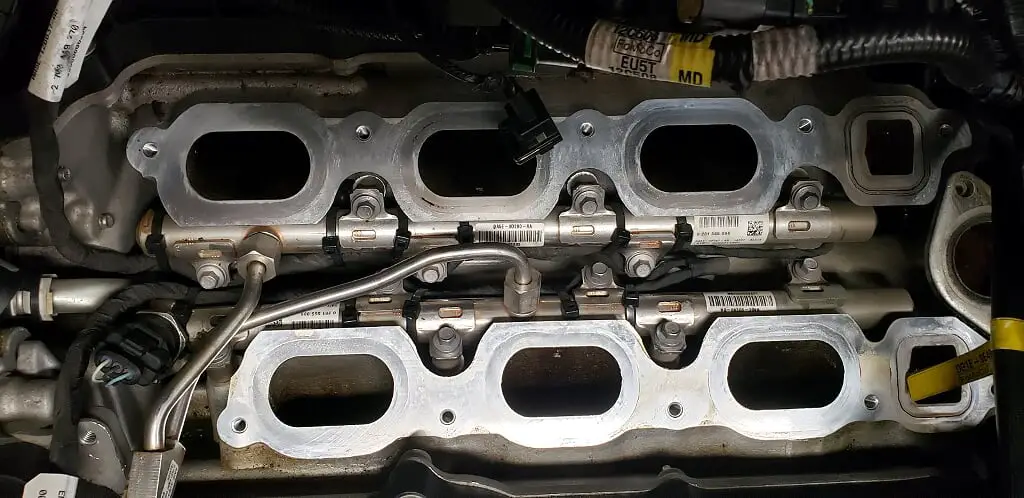

How it looks right after removal:

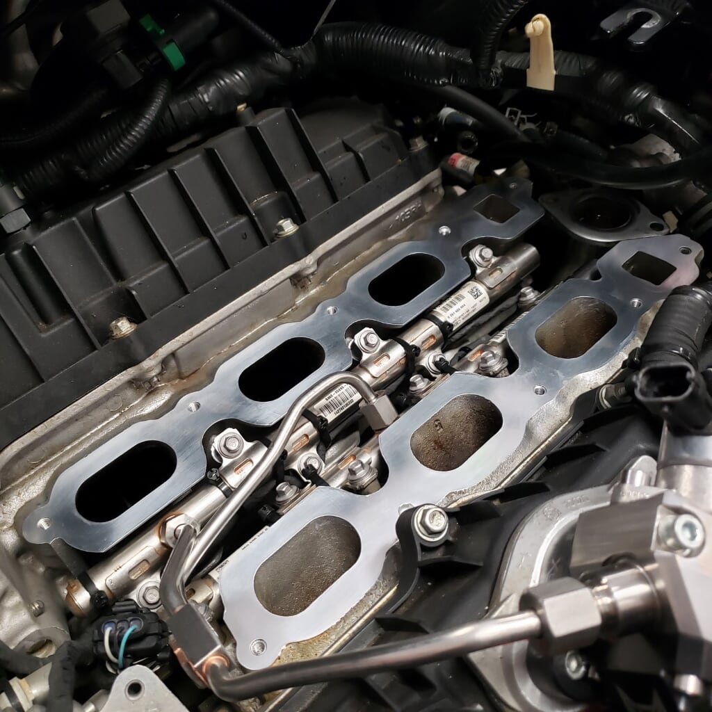

All prepped:
At this point, I completed the swap-over of the components off the stock throttle body onto the BBK one. There's a spring in there and some clocking that is necessary...
Ready for the intake manifold:

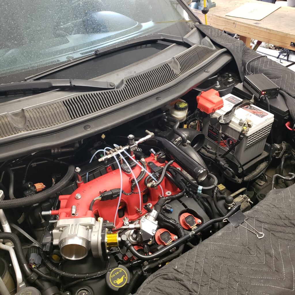

Got it going in:

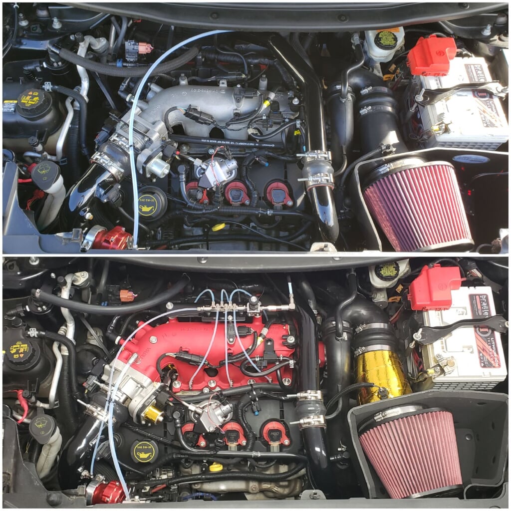

Before Shot:

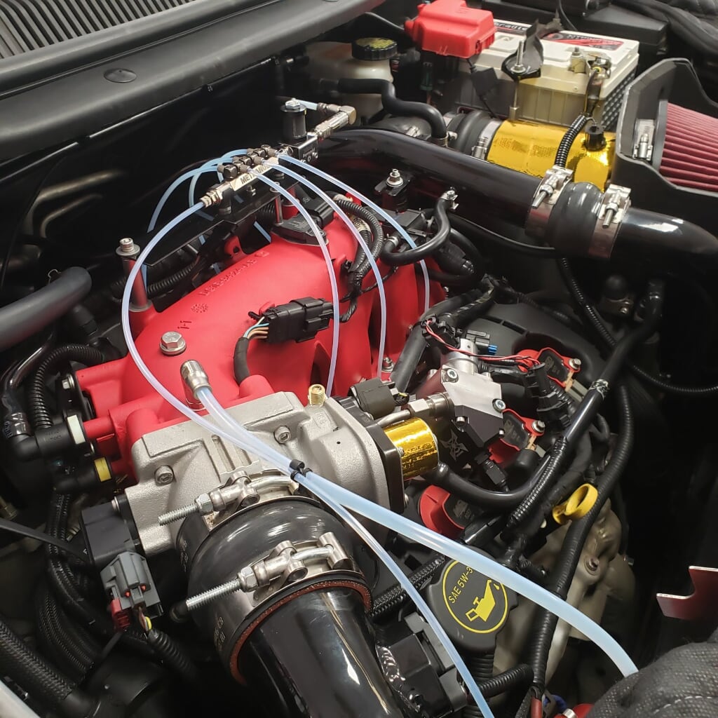

After Shot:
And a side-by-side comparison:
