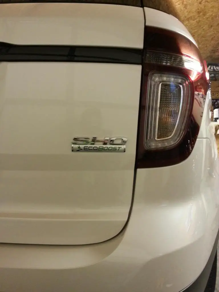

13tuxedosport I put the (Taurus) SHO ecoboost badge in place of the factory ecoboost4wd ,and love it

Do you have a pic of the back? Thinking about doing that to mine too

here is the emblem

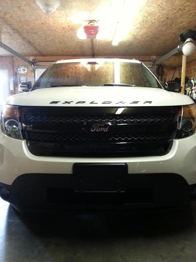

And the black grill emblem

SHO badge on an Explorer....wow. Good job, what's next?
SVT badges?

I bought a set of them off eBay .
