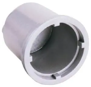

Find and buy this exact type of socket, should be 10-15 bucks at the parts stores.
I'll try to find a thread to link.

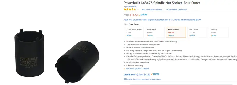

That style socket will work too, but not as well. It's the same, except it does not have the fat lip around the opening, which really helps keep the socket from slipping off.
When you're trying to reach 150ftlbs, even the lipped style wants to slip.
I highly suggest buying the lipped style, it's no more expensive and just as readily available.
