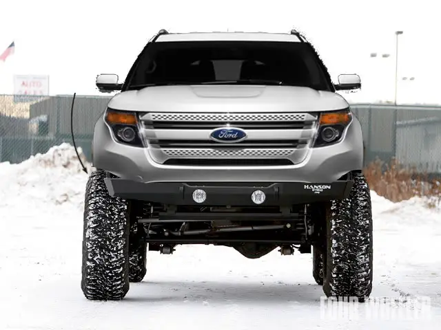

Yes, good, yes. I'm liking all of this talk of "cutting" amongst 2011 owners...one day, maybe, in a maybe not so distant time... the 2011 will be cool...
(Sorry Draper if this counts as "hating" etc. I just couldn't resist)
Ugh. I am definitely sensing a presence of a "hardcore purist" group in these forums. This car is a new, future-type SUV. I was thinking about the whole "badass truck type stuff". I realized that if someone still wanted to go that route, the expedition is the option they offer. They still have new 2010 explorers at the dealer too. I don't think its very effective to try and change a suv/car, into an "off-road demon". So ya, on that note. Anyone making a Toyota Prius Liftkit any time soon?
I'm sorry, I'm a bad egg anyway, don't mind me. You know some Euros lifted a Smartcar though. And there's a guy not far from where I grew up that has a dual SAS'd 2000ish VW bug. And in case anyone was wondering, that's a JK picture that I butchered in about 5min.
Also, Exp's really aren't "badass truck type stuff" anyway - they have IFS/IRS. (Sorry Exp owners, they still look cool)
Anyway! Back to the 2011, did not mean to hijack this thread at all.
That is awesome! :D
Looks good to me!!! Maybe I'll pick up a wrecked or beat up Edge here in a couple of years and do that to it!!
Ok- even I like that... :D
Now all we have to do is keep our eyes out for the first mildly wrecked 2011, it didn't take long for the Raptors (but that makes sense, they mauled it offroading).
I feel so special that people like my quickie photoshop - thank you all!
