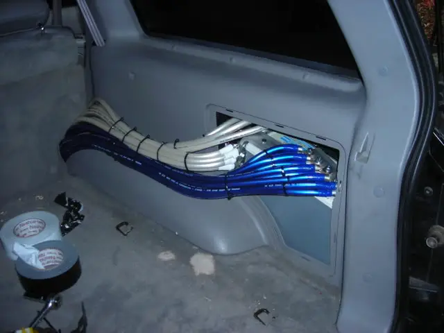

also for what its worth if you remove the stock subwoofer from this location its a perfect spot for an auxillary battery in the back. You can fit a fairly larger battery at that. Heres a pic of my truck with a Northstar nsb90 battery back there...which is about 70 lbs.
wow, how much did all that wire cost? nice clean install though.

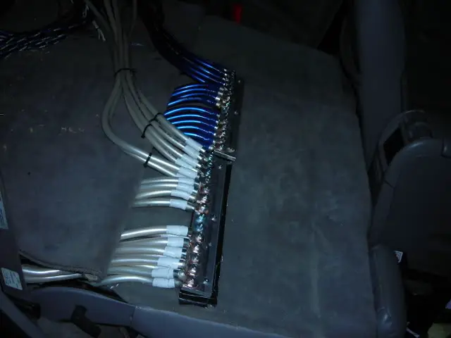

not too sure on the total cost...ive got another 10 runs from the front batt going to the back bussbars aswell...and then 8 short runs from the bars to the amps. In total I think I have around 300 feet of 1/0 in the truck I think. So thats around $525 in 1/0...plus all my lug ends, copper buss bars, aluminum buss bars, silver solder. It adds up in a hurry.
Heres a shot of my rear bussbars.
looks nice, you must be pumpin some serious beats.
