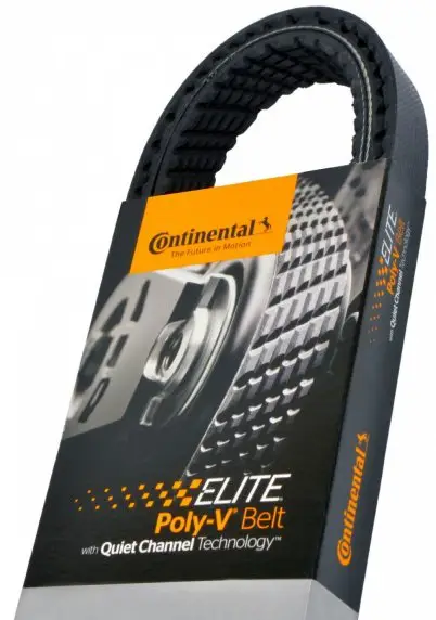

Continental belt used to be the good year gator belt. I like em and always use the gator belt now

4.0 CONTINENTAL ELITE 4060855
4.6 CONTINENTAL ELITE 4061010
