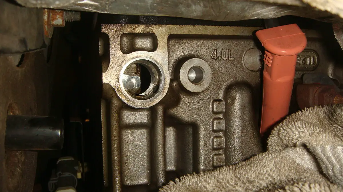

Started getting a very light rattle on start-up and every now and again after a hot soak re-start from the rear timing chain. Installed the new rear tensioner after I got off of work. When I compressed the old one it had very little resistance and oil came squirting out of the tensioner side. This was done right after I had shut the engine off after driving home from work, which is a 30 minute drive for me. So it had plenty of oil in it. I did not prime the new tensioner the old school way. Instead, I removed the fuel pump relay (#49 in the power distribution block) and cranked the engine until the oil pressure light went out. I let the starter cool for 30 seconds and checked the tensioner for leaks, then cranked again for another 10 seconds. Fired it up after re-installing the relay and was greeted by sweet silence. Checked the tensioner periodically for leaks while I let it idle for 15 minutes. Took it out for a good 45 minute drive after a quiet idle, so far so good. I know how these timing chains CAN go, so I was pleased as punch when the old one was actually shot. Glad it did not go the other way. (Knocks on wood)

A note to 4th gen owners who have not done this yet: In my case, I had to remove the entire fender liner assembly to get a straight shot at the tensioner. After removing the small flap, there was no way to get a good purchase on the tensioner. The fender liner takes all of 5 minutes to remove, and it makes the job cake once done. Also allows the torque wrench to remain perpendicular to the tensioner for a good positive "click".

The rear tensioner is no biggie at all. You will have no problem with it as long as you have a 27mm 6 point shallow-ish socket. You will also need about 16-18" of extensions and possibly a breaker bar or a 1/2" drive with a cheater pipe on it. Thread it on by hand. You should be able to thread it nearly all the way to the head. If you want to prime the tensioner before you install it then soak it in some oil and work the tensioner assembly back and forth until it gets very hard to push, nearly impossible. I just removed the fuel pump relay and cranked the engine until the oil pressure light went out, then another 10 seconds of cranking just for good measure. I did it in my driveway with my floor jack, jack stand and basic tools. Took me all of 45 minutes start to finish.

OP, did your original rear hydraulic tensioner have a sealing gasket? Mine did not and leaked after tightening to 50 ft/lbs. Loosened and tried 60 and it still seeped. Crossing fingers went to 70 until it sealed. Can't imagine the PITA it would be if I stripped the aluminum threads.
Oil stains ABOVE the tensioner port were from a previously leaking valve cover gasket.
@swshawaii-The original did have the sealing ring. My new one came with one too. However, the new one had a "wave" pattern to the ring, which is why folks have to use some grease to hold it centered on the new tensioner. I decided to re-use the original sealing ring because it was already "formed" to the tensioner base which meant I did not have to wipe grease on the new tensioner to get it to stay centered. If you re-use the original sealing ring just be sure to push it all the way to the base of the new tensioner. If it is fully seated you will see no "gap" between the ring and the tensioner. As long as you do not do something belligerent it will stay centered without any fuss. Thread it in by hand, you should be able to get it nearly seated to the head. I set my torque wrench to 50lb-ft (spec is 49 when re-using the original sealing ring) and let her eat. No leaks.
