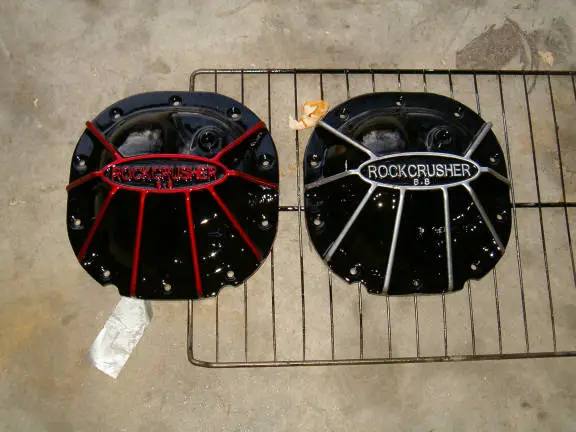

How do they look now?
they look good.. I want one now.. with some poweder coating :) (bright green/yellow)

I think you need to cash in on this JT! Buy all 48, powder coat them all, and resell :D
And I'm pretty sure he'll give you a percentage off if you bought all 48 off the bat :D
