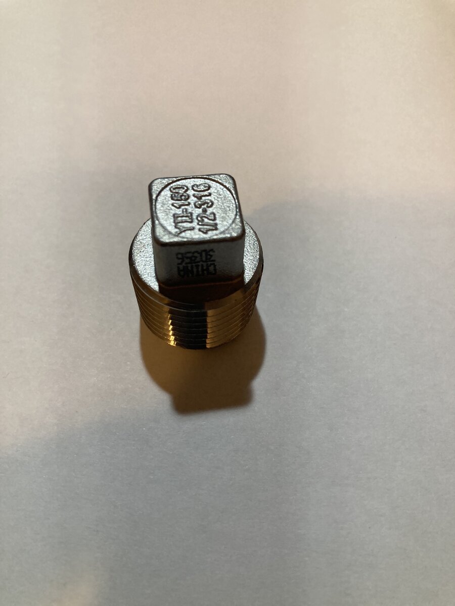

Hell, I even have them laying around in stainless. If they are truly impossible to find local (they aren’t) I’ll send ya one free.

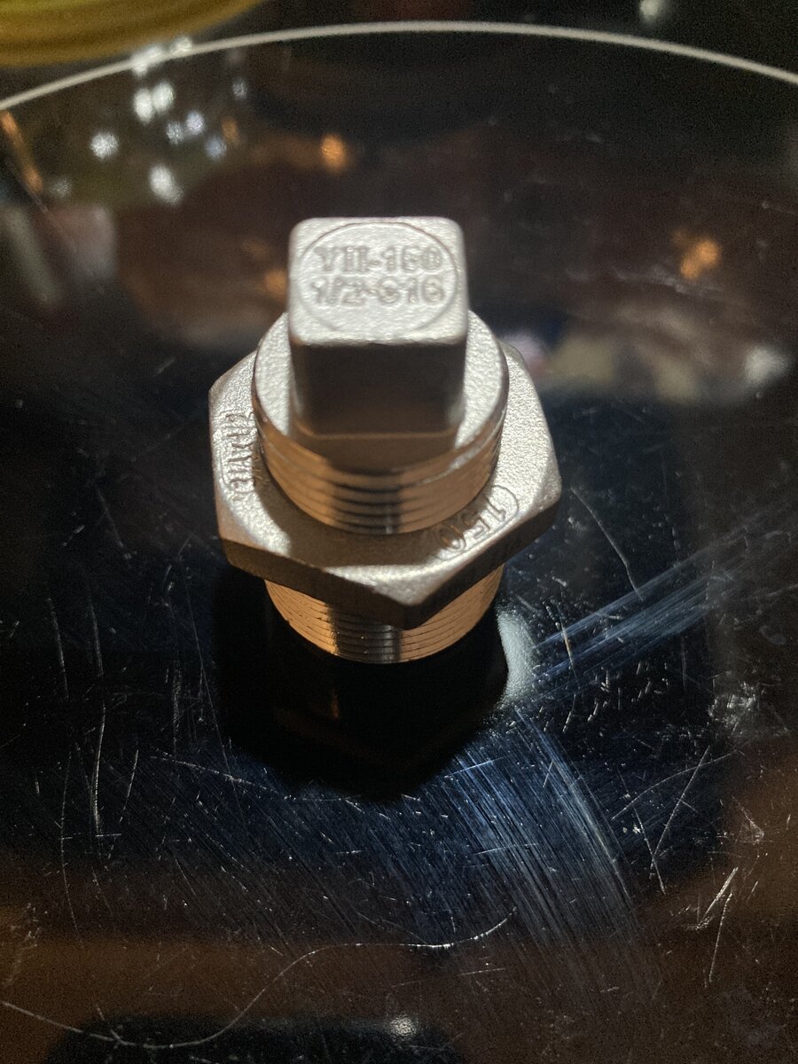

Behind door number 2 is a 3/4” with a 1/2” plug, in lovely 316 stainless.

I could polish it to look like chrome…
What do you use to polish stainless? Everything I've tried leaves a hazy film. That used to be a lot brighter
Mbrooks420
High Voltage.
February 2, 2002
13,593
4,299
1998 Mountaineer AWD
A fairly aggressive polishing compound and a scotch bright wheel. It’s more matte than actual chrome, but with enough elbow grease it can get fairly bright.
