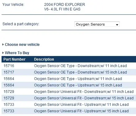

If replacing the O2 Sensors then consider using Bosch Universal sensors. Many parts stores carry them and they're much less expensive. With "Universal" units you clip the connector off your old sensors and use the included (waterproof) splice to attach to the new sensor.
I replaced 4 sensors on a 993 twin turbo and they worked like a charm.
Below are the Bosch part numbers for both OE (with connectors) and Universal (w/o connectors).
