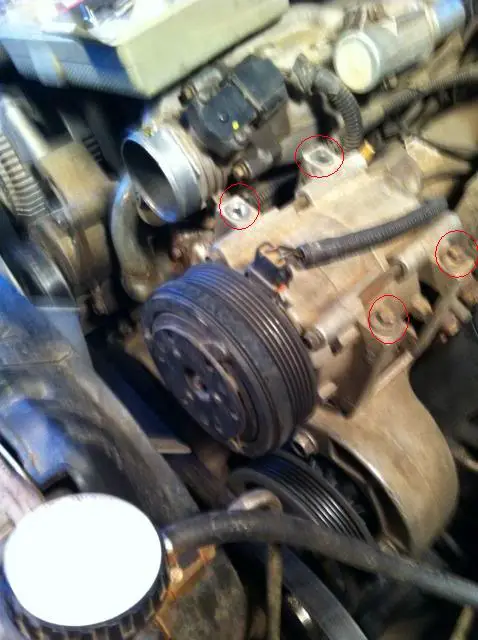

After I changed my mind and decided to fix it (it didn't sell), here's what I started with. I had already removed the belt and air intake thing, but the plug in question was right behind the bracket holding this A/C compressor and the power steering pump below it. These are the four bolts I removed to get the A/C compressor off. I'd already removed 2 when I remembered to take the pic.
The four bolts for the AC unit came off easily. I didn't disconnect any hoses and just shoved it aside. I had to kind of hook it onto something so it wouldn't keep falling back into place.

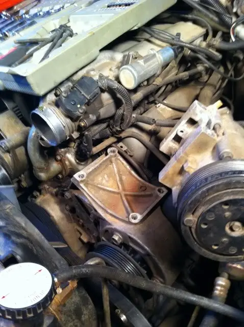

The three bolts for the bracket (bottom left) took care of both the power steering pump and the bracket itself. I also just shoved that aside.

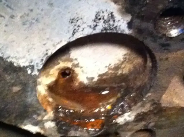

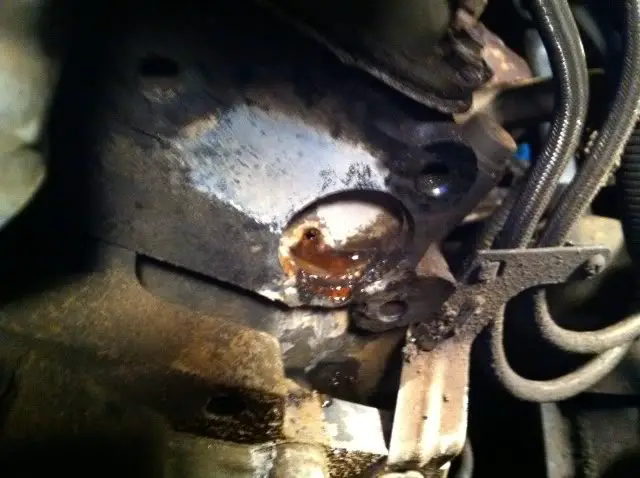

Once that was out of the way, the culprit was pretty obvious:
I couldn't believe that one little hole could cause so much water to come gushing out, even with the engine off and cool.

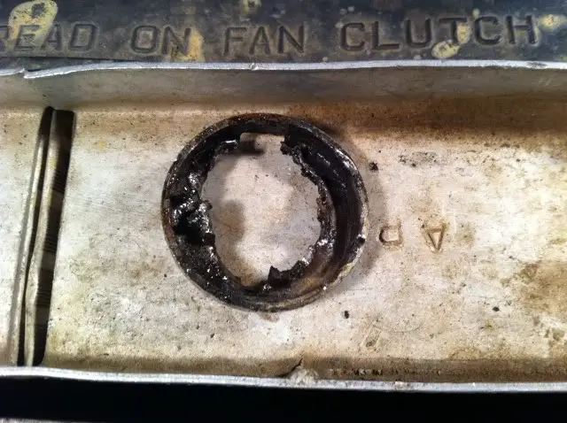

Getting the thing out was a bit of a pain. I started with a punch and hammer, but could litter push the punch in further with my hands. Instead of budging, it basically just broke apart. I hammered, I used the screwdriver, I got crazy with locking pliers. In the end, I triumphed and this was my trophy. One of my kids immediately claimed it and now it's lost somewhere in the house.
