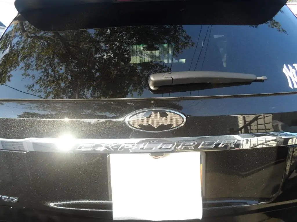

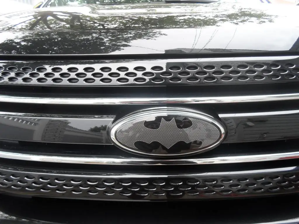

Handles and Ford Oval
I used my crapy iPhone 4s to take the photos. They were taken inside of my garage and the lighting sucks. Hope you get the idea of what they look like up close. I own a Harley Davidson Road King so I had to add a little touch with my Made in America toys! :salute::troops:
