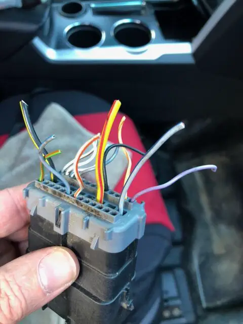

I'm about to attempt a replacement of the front seats in my PIU - got a set of nice, leather, heated seats from a scrap yard. Have a question for all the guys that done it already - how did you hook up and where did you mount the switches for the heaters? I have no issue finding power as there is plenty in center console but switches and wiring... hmmm.

yeah, that would be helpful - also, as I did get both seats with piece of harness attached I was able to put the missing wires into the plug and wire power passenger seat to one of the "Police" feeds in the center console.
I did come up with an "Air Bag" light after all - even though I disconnected battery while replacing seats. Hope ForScan will help me locate the broken link

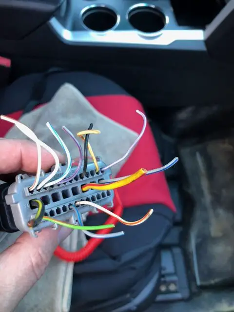

I have not been able to look into that yet - still debating over which heated seat switch to buy. I'm gonna have to take a look at the plug and socket an the driver seat again, passenger seat had extra four wires in the piece of wiring that was still attached to the plug (they just cut it. I incorporated those four wires into the original car wiring - connected power to the thick wire so the seat works, I understand one is for heated seat system but then I'm left with two addition wires that might be used for sensors? Will also look at wire colors on both sides of the plug - they might of changed wire location year to year.

The seats are in, power passenger connected - both work great - I did get an AirBag light come up and have not connected seat heaters yet so... all ahead of me

Just FYI - I did replace the seats, plugged them in and connected heat. Airbag light went out after reset. All good. If you have specific questions please let me know.
