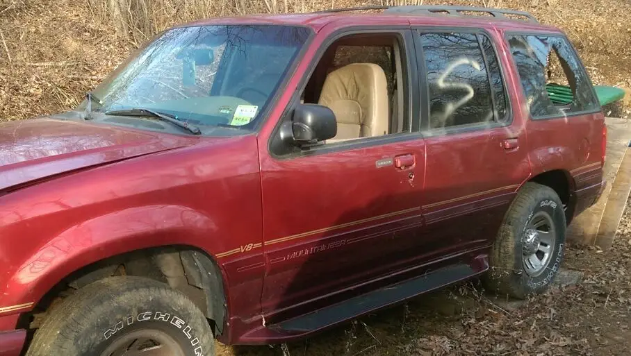

This is a multi part-er:
My 98 Mounty was broken into 3 years ago and has been sitting while waiting for some court proceedings to finalize. Tomorrow I am planning on begining the first major rehab steps.
First, I will be replacing the 4 windows that were smashed (Passenger and Driver Front Door, Driver Rear Quarter, Rear Lift Glass). The rear lift glass seems to be the easiest to do, followed by the rear quarter. The doors have me a little concerned with the rivets.
Can anyone who has done the door glass give me any idea how much time you spent on this, I'm trying not to get too far ahead of myself here with what I plan to do.

This weekend was very productive.
Before (Spraypaint, Busted front driver, rear quarter and liftgate glass)
After (spraypaint removed with brake cleaner. glass pillaged from '99 explorer wreck/parts truck, still need to grab passenger front door glass from junkyard)
Font door rivets were a pain. Used a combination of drill and chisel to cut, pry, and beat them out. Reinstalled with nut and bolt.
Window gets stuck rolling down. The window motor is healthy, comes back up like a champ. Looks like the scissor arm just isn't sliding properly on the window track. If I give it a little help it goes right down. Might just need to be greased up or I might have to replace something. Any ideas what to try?
