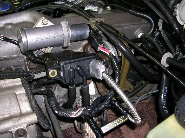

I assume you need a "DPFE" sensor. This, and the small rubber hoses going to it are a common issue. It looks like this-center of picture.
See the 2 rubber hoses going down from it? Take a look at yours to see if they are splitting, and also remove the DPFE unit to see if it is melted.
Some are made of metal, but they look similar.

From what you are saying it sounds like your EGR system does not have a DPFE (which is a pressure sensor), and uses a position sensor instead. Earlier Explorer engines were like that, but I am not sure about the year. Also, if your vehicle was sold outside of the US, the configuration might have been different, even for a year that used DPFE in the US.
Is there a sensor on top of the EGR valve, with an electrical connector?
In any case, I am with Turdle on the need to fix the problem. When the computer recognizes an EGR system failure, it will operate the engine in a less efficient way.
this dpfe does not suit my engine (1996 4.0l) we checked in ebay and found that the part that is shown in the link is theright dpfe.
The only explorer I know of to use a position sensor is 96 v8 which have an internal egr passage system.
All others use a DPFE, unless they are 93 down which have no egr at all.
