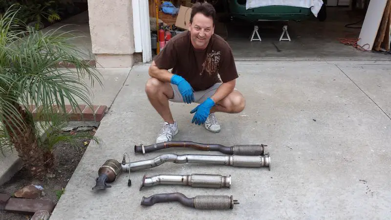

Full custom is nice, but gets pricey. Including the downpipes and labor from my exhaust guy, I'm in about $2300. Power is vastly improved but I do have some drone between 1900-2100 rpms which is right about 75 in 6th gear. Needless to say, I spend more time in 5th unless I'm doing over 80MPH. Because of the crank angle of the firing pulses on a V6, they have much worse drone than 4's or 8's. There is a fix that I learned from the Cummins Diesel guys, it's a dead-head chamber welded into the system that holds specific tuned volume of space. Finding that volume involves the displacement of your motor, the RPM's where the drone is and even EGT's(or so they told me). The result of the right volume piece is astounding, I thought it was hocus-pocus type stuff but a guy in FLA built a sliding inner/outer section that he could loosen the clamp on and adjust and he could change it from works perfectly to works not at all based on adjusting the slide(and volume) of the chamber. Mines not terrible and I just haven't built the chambers yet, but keep telling myself I will:D
