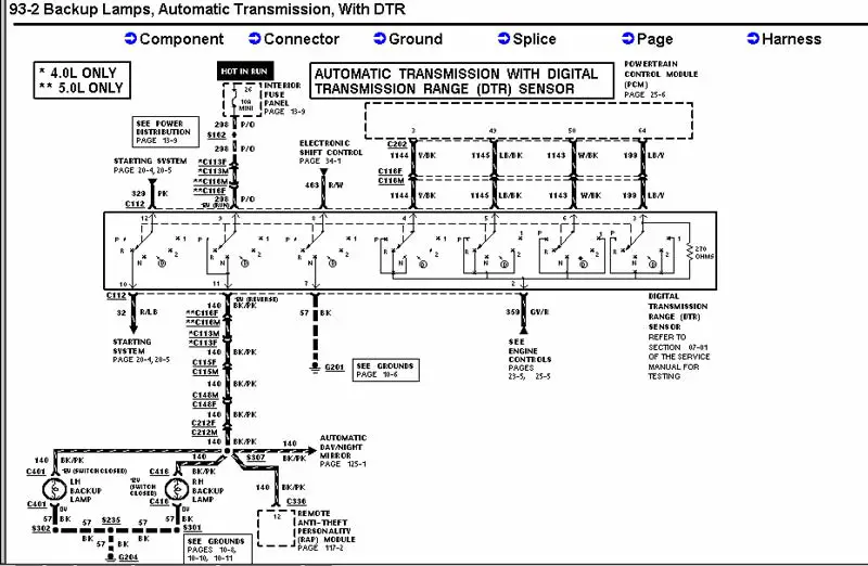

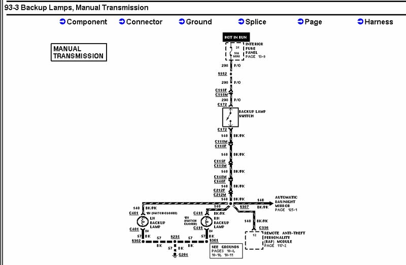

Does anybody know what color and where the reverse wire is located? What I mean is does it come out of the transfer case or the transmission. The reason is I want to make them flash off and on but I don't know where it is. There is so many wires under there.
