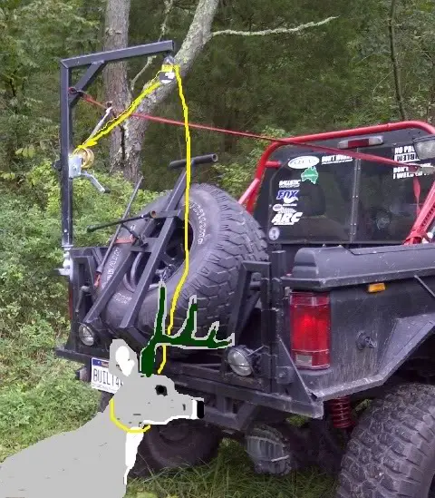

Painted all up and secured in the riding mode if I decide to drive with it attached to the bumper.
Took it out to make sure there were no problems while driving and it went fine.
Next was to make a rear mount that will let the crane swivel.
I just used an old trailer ball, large washer and a piece of square tubing that will slide into the boom.
Just did a trailer ball flip and welded the ball end with the flat part of the ball on the exo cage and the side of ball on the swing out tire carrier support.
The square tubing is welded to a large flat washer and then welded to top of the large nut.
Then slide the boom over the smaller square tubing and it swivels on the nut.
Make sure it rotates so I'll be able to lift up the load and then swivel over to lower in bed. The boom is out to the side in this pic.
The 8" long inner tubing keeps it straight while turning and additional support when lifting.
Next was to add one of those hand cranks for lifting. Got this at Tractor Supply for $19. Still need rope for it.
Here it is turned as if your going to lower or raise something in bed.
Also if I decide to drive with it located in the rear I'll use the ratchet strap like you see.
It took me a few years to do it, but most satisfying I must admit.
Edit: The ratchet strap idea on holding in position may change to a Pull Pin located near the base to hold in from spinning around, but strap will work for time being. I'll also add a gusset to the side of the ball.

Went out and purchased some steel cable for the hand winch.
Found a spare bumper mounted tow hook that was laying around and thought that would fit the bill perfectly. 10,000# rating, a little overkill but it's not doing anything constructive laying in a tin can.
Also the snatch block tha you see was actually a brand new sheave block, but a removable pin in place of the bolt did the trick.
Now the cargo carrier compliments the "BuckCrane" ;)
