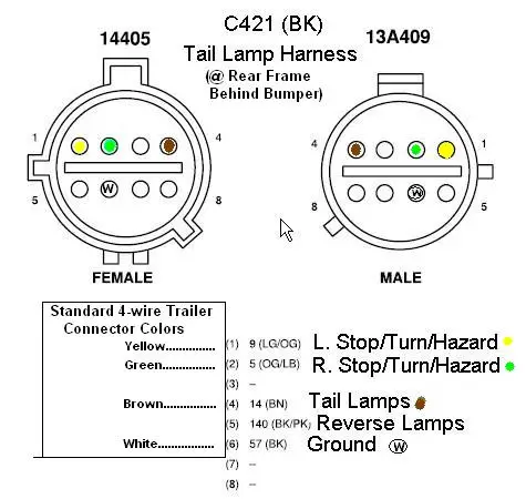

then you will have to check each connector , with a test light, to locate the fault. Start at the black connector behind the rear bumper on the left side.
You should have power to pin 2, green in the diagram. (Orange/Lt.Blue wire)
Try that then we can move on towards the front.

I haven't had access to the truck for a while but my son is out of town and I have the truck for a week. I need to start this troubleshooting again. I verified that the tail light and reverse light is working. The right turn, stop and hazard is not working. Should I start checking at the turn signal switch or the connector behind the bumper???
I just checked the connector at the left rear bumper On the female connector I have power to the tail light pin and both the right and left stop light pins( yellow and Green) when I press the brake. Where do I go from here?
You mentioned (or did you?) that a trailer plug was wired into the harness. I'm assuming that was done between the plug that you've verified to be working properly and the tail lights. I'd dig into that. If you " have power to the tail light pin and both the right and left stop light pins( yellow and Green) when I press the brake" then my bet would be the problem is at the trailer plug splice-in. I mean it HAS to be between the connector and the actual tail light bulb.
OR
If you remove the tail light assy, take the stop/tail/turn bulb out, disconnect the bulb holder from the harness you should get power on the #3 pin, OG/LB. You can check that first if you like. Those holders do go bad.
You can also see here where the wiring runs along the bottom of the bed. It may be damaged there somewhere due to the accident.
I think that I just found the problem. He was in a wreck a few months ago. He was hit in the left rear bumper.
I had no power on the "Major" pin of the bulb socket, only the minor. I started tracing the wires back to the connector on the left rear that you told me about. I found the wires damaged. It must have been making connection from a few strands and finally broke. I am going to solder them back together now. I will post in a few minutes, but I am confident that this is the problem.
