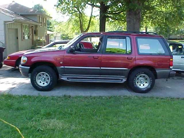

If you stick with a 30x9.5 tire you can't go wider than a 15x8 wheel.

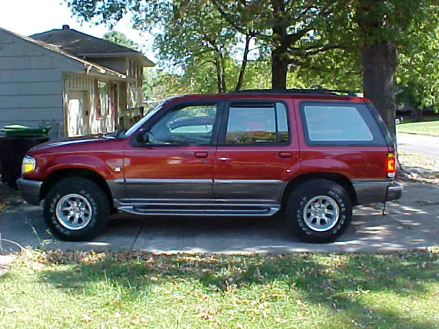

I have 15x10's with 31x10.5 and that is pushing it for a 10.5" wide tire let alone a 9.5" wide tire. Also with a 10" wide wheel you will have trim the plastic trim on the bottom of the fender and the air dam on the front bumper.
This is a pic of my 31x10.5x15's on my old 15x7 wheels.
The third pic is my 15x10 wheels with the same tires.
