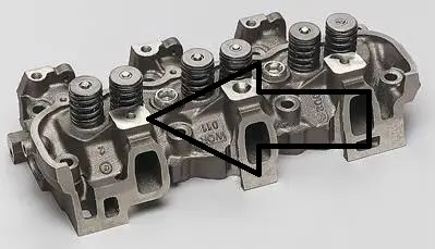

Move it to a different valve.
Get it away from this:
Or work this down instead.
Some of the valves are position specific and have had extra material already removed to clear the mount.
