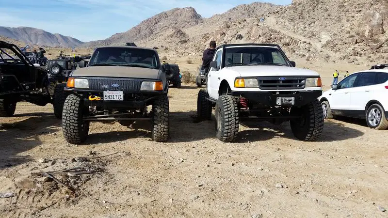

A rare 2 ranger sighting at koh. Tbars needs to chime in with his even rarer 3 ranger pic![]()
