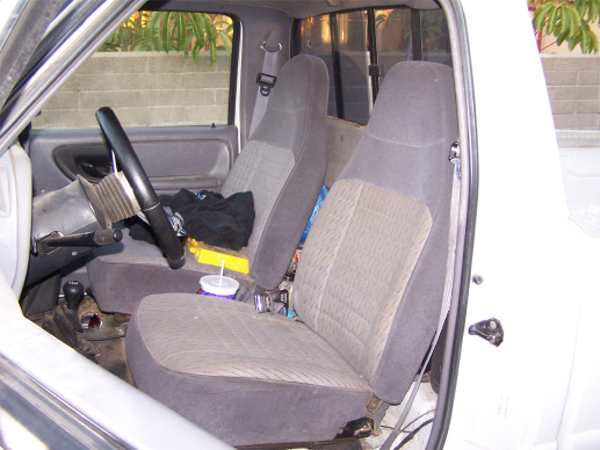

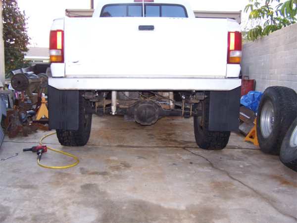

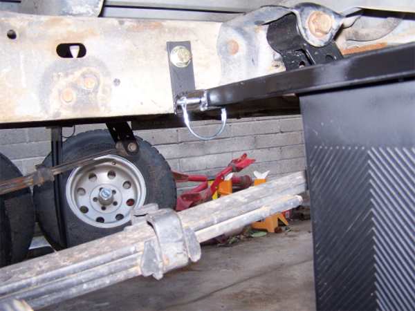

So I got a few hours today to work on the truck today. Basically all I got done was built some removeable mudflaps for the rear tires and pulled out my worn out drivers seat and put in RangerX's old passanger seat as my new drivers seat. This gives me the ability to put a center console down the middle of the truck eventually. I also needed teh space for my duel tcase shift lever to eventually come out through the floor. I also want to add a hand operated ebrake handle instead of the floor mounted one I currently have.
haha, i didn't think that would work like that... will the seat belt connect anymore? and isn't the recline lever on the inside now, getting in the way of a center console?
What's that mudflap hanger made from? Looks beefy as hell!
Seat belts are fine. They are attached to the floor not the seat. I also took the center lap belt out and moved it to the driverside. That way when wheeling I can wear the lap belt and not have tlways be pulling down the sholder harness. I am going to raise the back seat mounts 3/4" once I get some longer bolts. I still feel like I am sitting in a hole. It should also improve visibility over the hood. Yes teh recline lever is on the wrong side. I am going to try to pull them off my driverseat and see if I can get them to fit so it will end up on the right side. Just ran out of time last night to mess with it.

Hanger is made out of 3/4" square .120 tubing and some 1/8" flat stock bolted to the frame. 1/4" pin and when pulled out they come right off.
Yup there is a Dr pepper can hiding in that pic in two places :D
Matt yuou should be able just to use his fabric and foam on your drivers seat frame? Or was it a 60/40?
those mudflaps are missing something....
