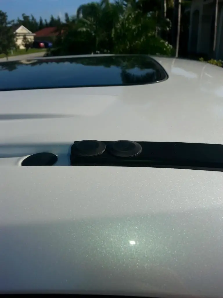

First Post...I just removed my rack. Used those black trim fasteners, the kind that push on to hold fender wells and such. Can't even see them in the gutter. I'm 6'5 so if anyone can see them it should be me. Used some sealant, pushed them in and done. As for the black trim piece, that was a little more tricky. Your left with a tab sicking up which you'll have to trim out. Then what to do about the two square holes left in the trim piece....... Well, used two of those fender thingies, trimmed the stem and super glued them over the holes. It actually kinda looks like they are supposed be be there. Then more adhesive sealant, put them on and done.
All in all, looks pretty good for a 30 minute job. I'll have to find time to snap some pictures......
Full vehicle pics please
Very nice. Great job:thumbsup: . Thanks for sharing.
I'd like to see some more pictures! :thumbsup:
