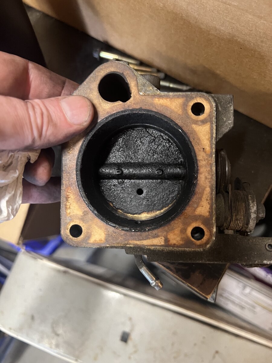

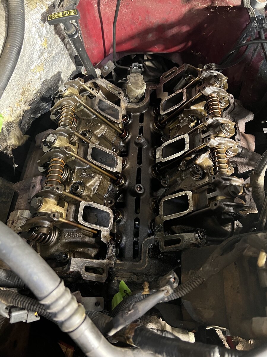

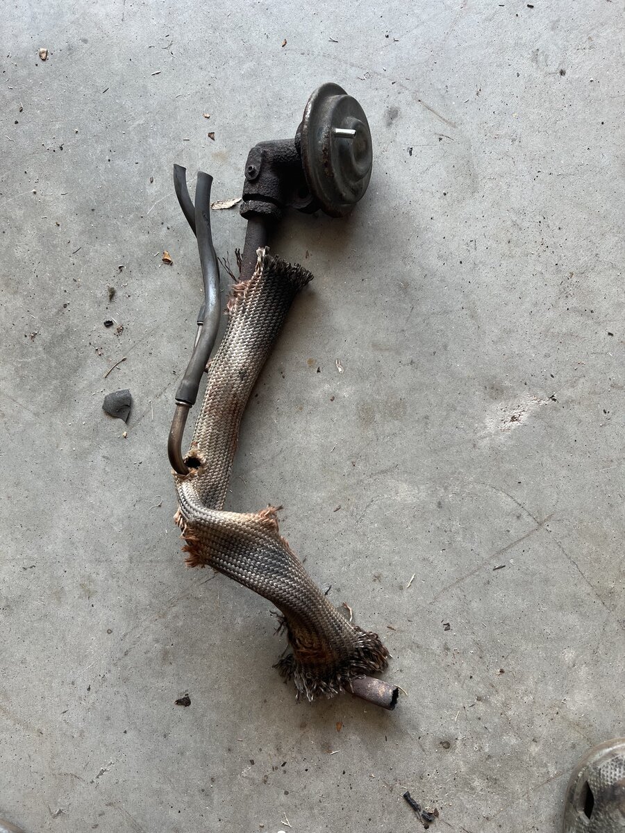

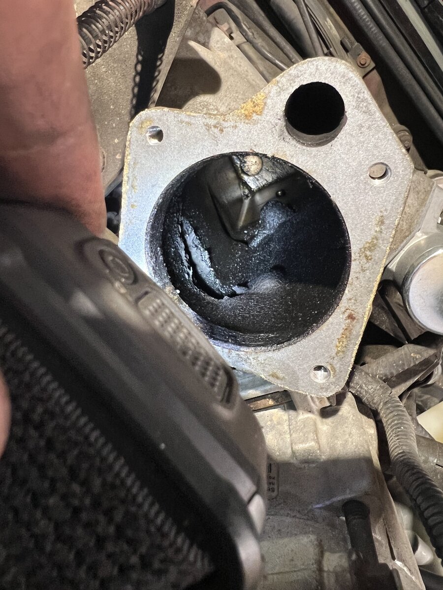

Thanks for the tip! I actually did replace it when i took the upper & lower manifolds off. Everything was caked w/ carbon. I was able to find motorcraft sensor and an air intake sensor as well. I was hoping the cracked/leaking egr tube was the culprit but i was able to get a new motorcraft one of those as well. The only thing non-motorcraft so far is the MAF. Thinking i need to dig into the wiring closer.

DPFE was replaced with EGR and egr tube. (the EGR tube was rusted and barely holding onto the manifold). Took me a full day getting that removed it was rusted so bad. The DPFE tubes were bad but i got a new set of silicone. I kept the original DPFE (and all other parts to bench test as i learn how to do it..so as to pass down to my son).
