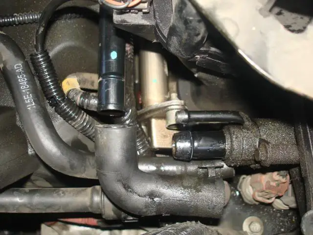

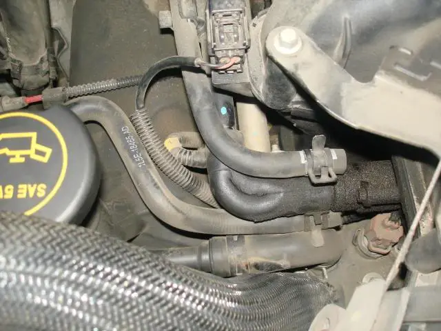

I had the same exact problem in my 2003 Sport-Trac V-6.
Same fix except I used a piece of hose bought at Autozone for $8.00
Infamous hose leak before:
and after:

Syber Tiger,
Thanks again - I guess the link I clicked on from your last response was pictures from
Wade Davis's 2003 sport TracV-6. It left me a bit confused. These pictures and write up of yours is exactly what I needed. The hole is where yours was. I will be going to Ford tomorrow with a print out of your info. GREAT write up - thanks for taking the time

Another successful fix!! I retrieved codes P0171 and P0174, lean condition right and left bank. Went to this forum and found this thread. So, I lifted the cover off my 2003 explorer XLT 4.6 V8 and, sure enuf, the elbow was deteriorated with a signficant hole that looks like a carbon copy of the one shown in this thread. I checked the remainder of the assembly and all looked ok. So, i went to the local parts store and bought a $10 elbow, installed it after cutting to fit, erased the codes with my Equus, and no more problems. thx to all for the info. saved me time and $$$.

Hello everyone, I'm Steve. I'm new to this forum. I have a 2003 F150, but the same elbow problem as Sybertiger on my 4.6L V8. I just figured out my problem yesterday unfortunately before reading Sybertiger's post. His great post with pics are identical to mine. Same hole and everything. If you are interested in using the Elbow Autozone has that fixed mine here is the info on my receipt.
#883116 S-3015
S-3015 Kelly Springfield Bypass Radiator Hose
It's just a hose, no clamps used. Cost $7.99
I want to extend my thanks to SyberTiger for this thread and to Steve from Biloxi for this particular bit of info. I have an 03 XLT and while working on the IAC valve this afternoon, I tore a hole in this elbow. Went down to the local Autozone and part #883116 still works. It got me exactly what I needed. Thanks guys.
