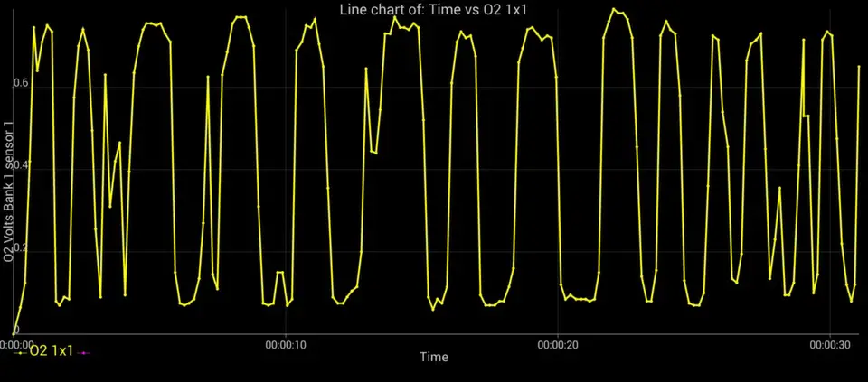

I am continuing to get a P0171 and P0174 code. I have changed out the fuel filter, upper/lower intake manifold gaskets, EGR Gasket, and PCV Valve. I have cleaned the MAF sensor and check for other leaks. Below are some screeshot that it took of the O2, MAF, and Fuel Trims. Any ideas what direction to go in next.
It takes a couple attempts to start from cold and there is some hesitation accelerating from a stop. Once it is up to speed no issues.
If it comes from the ODB2 port and I can get some more info let me know what might help.
These are all at idle except the MAF
O2 Bank 1 Sensor 1
