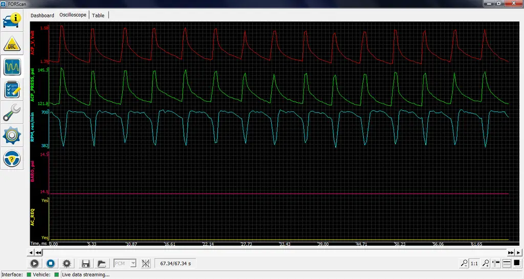

Has anyone found a solution to this problem. My 2013 Explorer has a rough idle when the AC is on. The compressor kicks on and off and doesn't blow out cold air at the vents. This happens sporadically, but seems to be happening more often.
So, where are the expansion valves located on these things? Are they on the engine side of the firewall and underneath the vehicle? Or are they tear the whole interior apart to get the air box out to get the expansion valve out? I don't mind doing the work. I do mind a bit spending the money. I WILL mind it if I have to rip the dash apart to get to the expansion valves but I have a funny feeling they are just on the otherside of the firewall and just the other side of the underside in the rear. Just inside.
thanks looks like outside of firewall if what I am seeing on that stud is correct should be pretty easy to change if I wind up having to change it.
