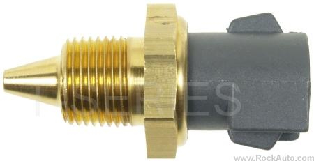

My first guess, based on your description would be this:
It's the temp sensor for the PCM
The one "near" The housing for the PCM looks like this.
It is a bad Temp sensor.
http://www.rockauto.com/catalog/moreinfo.php?pk=951148&cc=1119631
Been here, done that already on the 94.
Flooding because the PCM "thinks" the engine is cold... .
There are (2) sensors, so make sure you change the one that has a cone on the end of it, next to the thermostat housing.
Seems like we are having a rash of these right now. Warmer temps outside?
