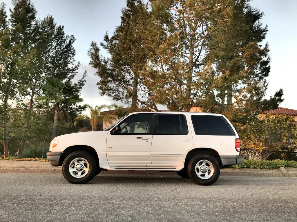

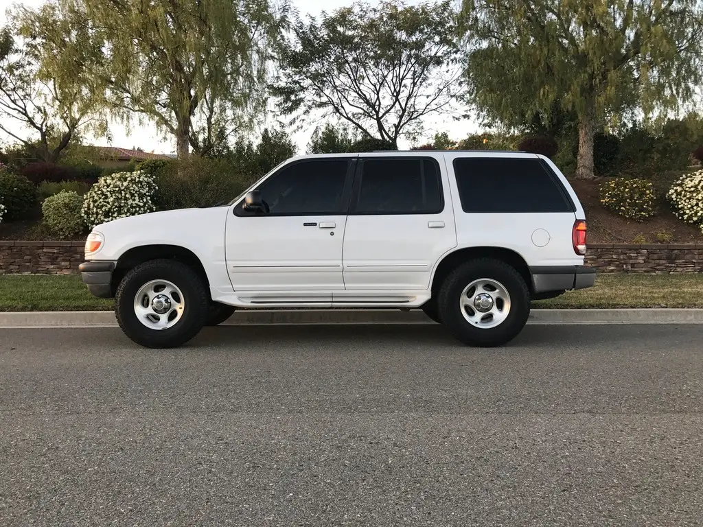

So this will be my 5th Explorer. I've owned a 00' Eddie Bauer V8, a 99 OHV 2wd, an 01 Limited V8, and most recently, a heavily modified 94 prerunner.
I sought out this specific combination for over a month. I am very picky about cleanliness. I needed 4x4, and I did not want to mess with a transfer case swap with a V8. So here is my spec list of the "perfect" Explorer that I was finally able to find.
98 XLT
147,000 miles
SOHC/5R55E
4x4
4.10 Rear end with limited slip
Color matched grill
Running boards (could have lived without them)
Leather interior
An inch thick file of receipts!
My plan for this truck is to keep it as a comfortable daily driver, as well as something that is capable enough for the overlanding adventures that I like to do with my family.

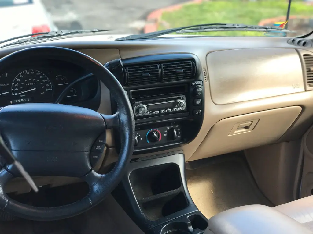

Going to get all the creature comforts dialed in before I start tearing into this thing. My kid loves this feature so far. This truck has the rear air with the headphone jack, so I love it too! Next up is tint.

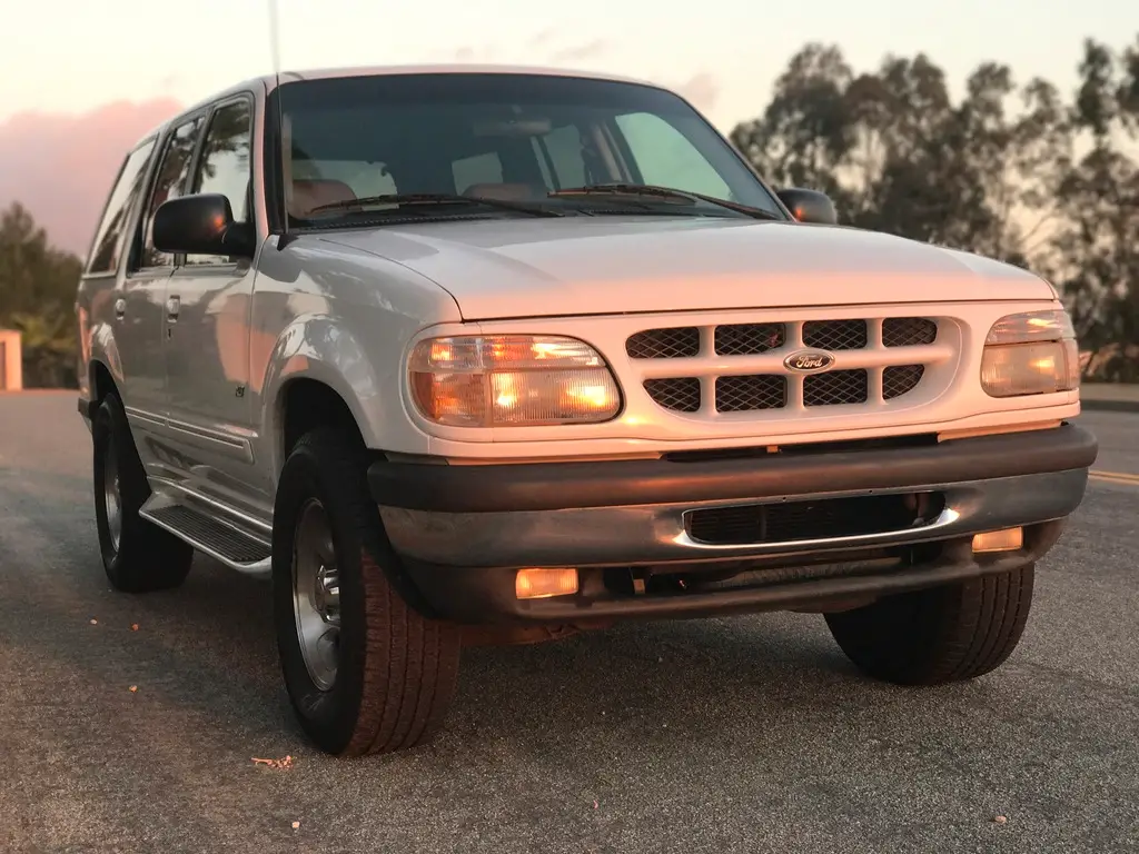

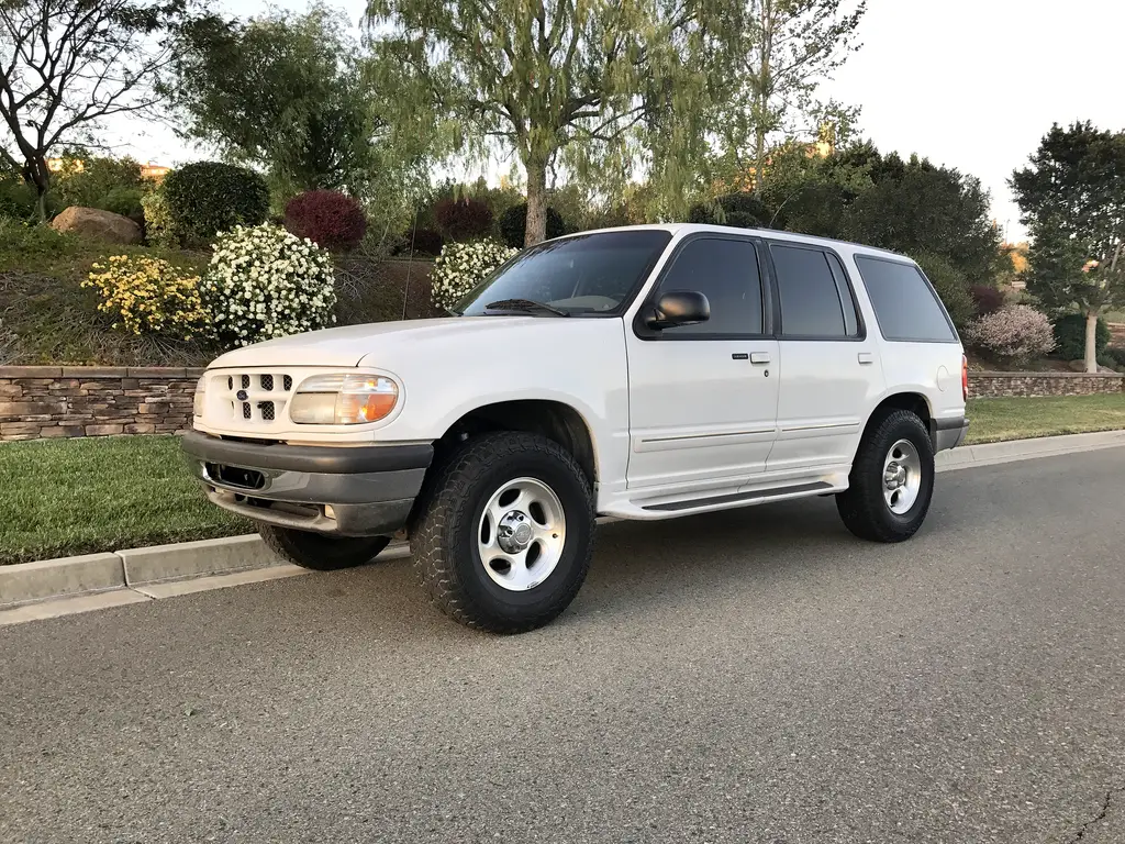

Starting to look like something. Threw some 265/75/16's on and cranked the torsions a little. Next up will be a BTF uniball upper arm, torsion keys, and 2.5x8 FOA's.

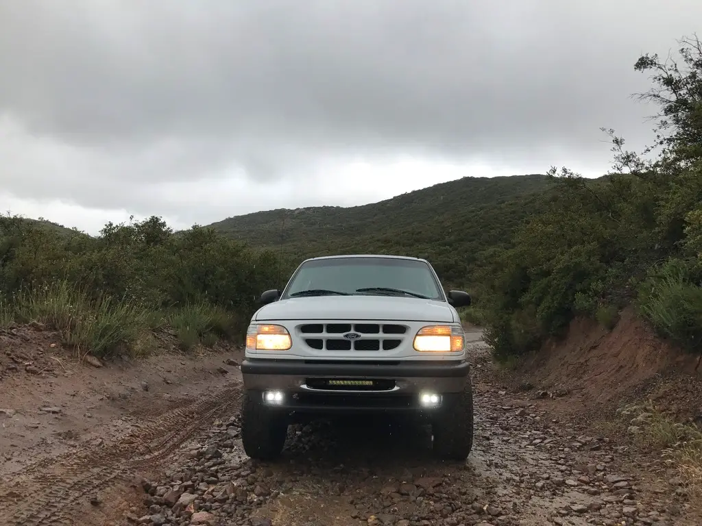

Few upgrade on this off road beast. Threw on some BTF uniball uppers and some torsion keys. This stuff really helped get a lot of slop out of the factory setup. Cant wait to get some decent shocks on it. Here's my latest run that I did yesterday.
