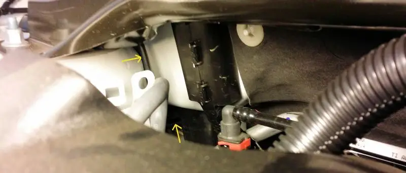

I would love some help from those of you who have routed their power cables behind the glove box. I just took it apart and I don't see any way how this is humanly possible. I've ran 4 and 0/1 power gauge wires through the firewalls of almost all the vehicles I've owned for the last 27 years, and after looking behind the glove box area of the Explorer, I'm pretty stumped.
Here's a picture behind the glove box after it and the felt-lined owner's manual pocket above it have been removed. The yellow arrow points to the rear windshield washer line. Where this line runs through the firewall is buried FAR behind and around the corner out of sight. No way of running a wire through from this side.
Here's the view from the engine compartment. The line runs behind the strut tower. It would take Rubberband Man to get anything back there. I couldn't even begin to get a coat hanger wire back there, much less be able to see what I was doing.
Any ideas? At least in the 2015 Sport model, this myth has been BUSTED!

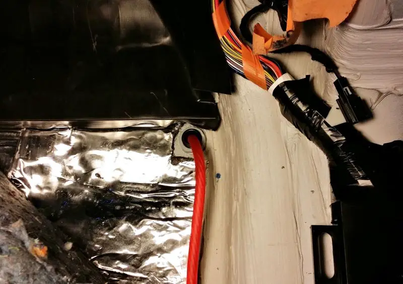

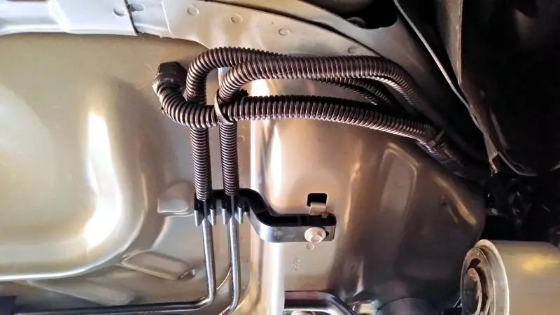

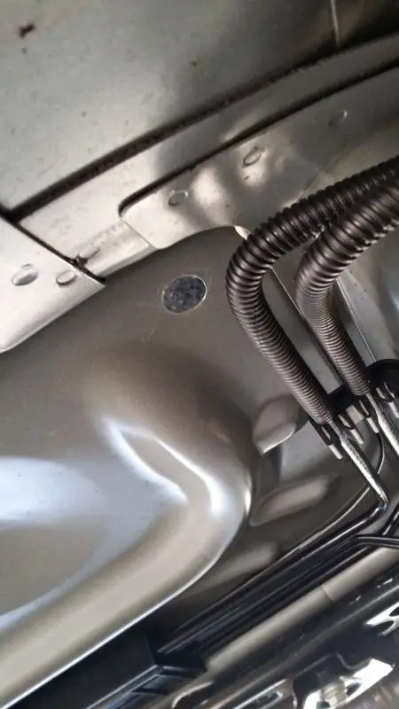

Okay, all done. Ditched the behind-the-glovebox idea. Instead I ran my 4-gauge along the strut tower bar, down beside the engine to the floorpan and then up through the floorboard. Not too difficult.
Upper right-hand corner of the passenger floorboard:
View from underneath:
Power wire up through the floorboard w/ grommet:
View from underneath after everything's zip tied and wrapped in split loom:
