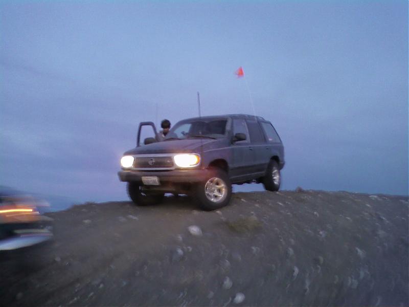

i just removed mine recently. i also hacked off the bottom of my bumper. it's sweet. im not gona bother with looks since i rolled it a month ago and im getting a sport. having them and the bumper off really helped out in moses lake, the dunes were awesome.

aeaglenfitch, i like the way your mounty looks with the bumper trimming. I did it to mine a few months ago and i just can't believe i waited so long to do it, it looks great. I also only had 1 fog light that was barely hanging on by 1 of the 3 screws anyway so i didnt worry about losing those.
