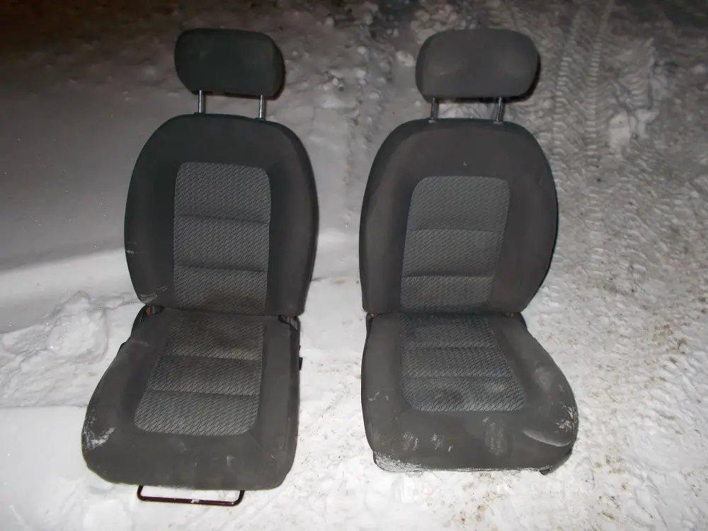

11. Install proper, safe seat belt buckle mounts on the floor to go with the seats.
