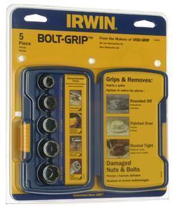

Rather than jb weld i would use something like this
They have sharp wide reverse thread inside that cut into whatever your winding onto. ie as you lever anticlockwise to undo the bolt these babies grip more.
Used in combination with penetrant and maybe the extented time of force as decribed above you may have some joy.
As an aside, i have read about mechs in the good old days using this method to remove wheel hubs off old jags. They would torque up a puller REAL tight then wrap a matress over the hub and leave overnight. Next morning the assembly would be across the other side of the workshop.

I appreciate the information guys. I am not sure about the penetrating oil prior to the application of the jb weld. I am not sure what the residue might do to the jb weld mix. or how well it might hold.
There isn't anything left for a socket to be tapped on to. the plug looks like it never had a area for a socket its a 90 degree angle from the ceramic to the head.
I have decided to do a test run, I have a set of heads that are in need of being rebuilt(they were going in the ranger eventually) I am going to grind off the area of a spark plug that the socket needs to turn it out. put it into the old head and try the JB weld and socket.
Its not the Best test since its not rusted to powder but it will tell me if the JB will adhere to the ceramic with enough strength to turn it back out. I am also concerned that what might happen is the ceramic will bust out leaving the threads in the hole. or just bust off leaving ceramic AND the threads in the hole.
I bought 8 sizes of those reverse threaded removal tools tonight along with some other crap I may or may not need.
