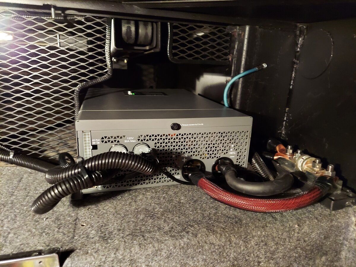

Spent the day getting it wired and installing the new battery box in its new location. Took me a few hours to finally decide on this spot. Its easy to get to the batteries and fuse, I can still store stuff forward of the box, and its within a few feet of being directly across from the other battery bank. I need to clean everything up, seal up the hole I made for the ground wire to get to the frame, and put everything back in the storage compartment.
Box and fuse location. I can unbolt the box, unhook the cables and slide the box over to the edge of the storage compartment. I can even tip it over to remove the batteries since they are AGM.

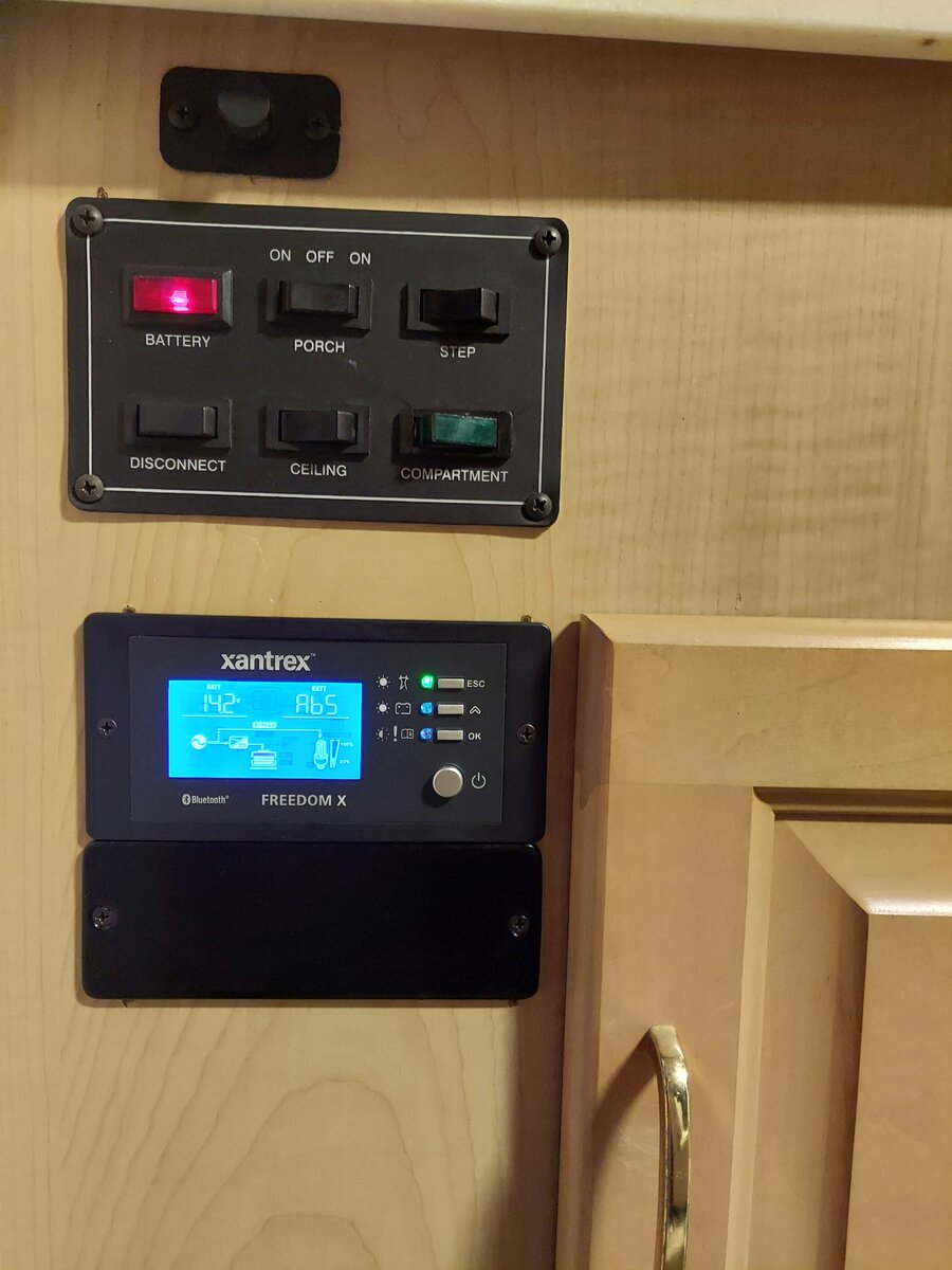

I first mounted all the wiring, then installed the fuses to make the wires live. The remote panel immediately came alive, and I had a successful inverter test. I then plugged in the shore power and it immediately started charging the batteries. It has a 20 second delay where it "reads" the incoming current before allowing it into the coach. All good. I set the battery function to AGM and decided to not mess with anything else. Haven't tried the blue tooth option yet, will do that tomorrow. It was still charging the batteries when I closed up the RV for the night with the two fans going full tilt. It really pushes a lot of air through that pass through storage area.
I actually installed it backwards to the way the old unit was in because this one has every attachment on one side. The only thing on the other side is a 20 amp breaker that I can reach and the two pusher fans. This way all the connectors are accessible without moving the box. I ran the cable from the driver side battery bank through a piece of conduit and its double wrapped with flexible loom to make sure its protected. Still need to notch the fuse protective covers so they fit with the way I ran the cables.
This unit is much more user friendly than the Prosine 2.0. It has a much smaller manual and lots of pre-set functions so you don't have to program the entire unit. That Prosine manual was several hundred 8x12 pages, designed for and by a electrical engineer and was very confusing. This one is about 75 4x6 pages total with lots of simple diagrams for morons like me.
One thing I do not like about it is the way the AC romex wiring mounts. It has this flip up levers, you push the wires into slots and lock them down with the levers. Its all mounted on circuit board and I could see it flexing when I was attempting to shove 3 solid copper wires into the slots while holding up spring loaded levers. The DC wires are also mounted to a separate circuit board, but at least that has a big piece of what appears to be aluminum for the lugs to bolt onto.

What should I put in this space below the remote? Its 2x4.5" of usable space. I was thinking of a volt meter, even though I have one at the main control center for the coach in the hallway. The inverter has to be on or the coach has to be hooked up to shore power for the remote panel to come on. Don't want to put some type of USB or plug charger just because there is no shelf or anything to set things on there.
Maybe a double volt meter so I can keep track of the coach and chassis batteries in one spot?? That would be easy to wire because the panel above has power to it from the chassis and coach batteries.
Something simple like this
I played around with the bluetooth function today and its through a app. If you close the app, you have to go over and manually reconnect it to your phone. Not really worth having, except for the settings feature is more user friendly with the app than the panel.
Red Lion makes a lot of meter type read outs that could be configured to show many things, such as peak and lowest voltage, and current amp load. They are very robust and you can often find them used for reasonable prices.
Thanks. The inverter remote panel does all that if I turn it on, or if its hooked to shore power. It can be configured a bunch of different ways. I am happy with the presets. Default has all the basics on it and you can page through five more readouts for battery and five more for shore power. I just want something that I can glance at to make sure the batteries are charged.
Edit: I ordered two of these. They look OK, will tell me the voltage at a glance and will be easy to mount/wire.
