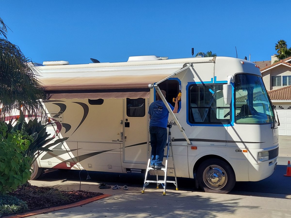

Guys repairing the RV windows underestimated the job by at lest 12 hours. They didn't realize the windows have a rubber gasket holding them on the inside, and a metal frame on the outside. Most windows are metal on both sides and screw in. These basically press in and then you have to fight the gasket to get it to lay flat. Most of the windows were not square in the cut-outs from the factory, or have shifted. They lined them up nice, and used window sealant urethane to set them in place. They said if anyone has to remove a window, it's gonna be a ***** because they basically glued them in. They are finishing up today. I'm giving them a 10% tip because they are very meticulous for being 19-21 year olds. Windows look great. I didn't realize how badly fogged they were until they were fixed. They are finishing today, day 3.
I highly recommend the "RV Glass Brothers" out of Hemet if you need any auto or RV window glass repair.
It is a breath of fresh air when I see the younger generation caring about the work they do. I make a point to thank them for their true craftsmanship.
I learned the fine art of how to make perfect caulk lines from a 21 year old kid.

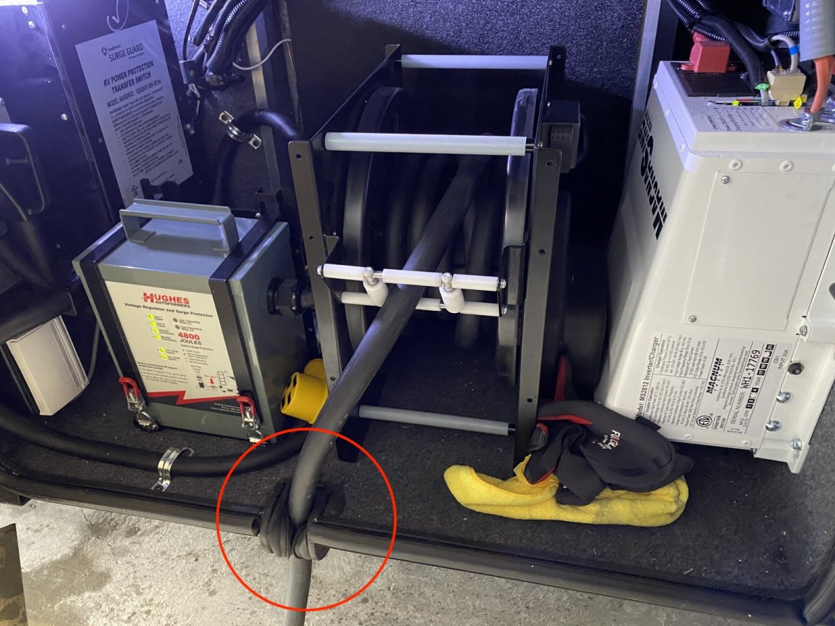

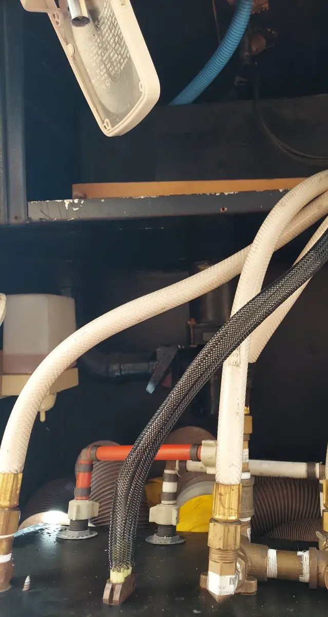

Anybody know what the grommet is called that is circled in red in the pic? It's something I never knew I had to have until I saw one. Need one for the electrical cable and water line doors.
I've done a bunch of searches and can't find them. Someone on a RV site called them a "stirrup" but no success with that search either.
I found this. Similar function different design.
Did more searching and asked on another forum. It's not a pre-made piece. It's a few pieces of door seal and some metal plate. The plate is welded into the notch and the seal is screwed to the plate. I'll have to fab a couple up. I already have some ideas to make them better than what they did.
Has very high end cable gland/guide solutions. I’ll check work later, I might have one or two laying around.
