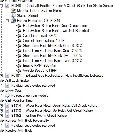

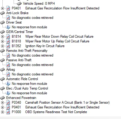

Did some more little projects with this today. Painted the front grill. Installed a stereo. Cranked the torsion bars up. Got rid of the steps. Ran my odb2 reader on it to see what all is happening. Got p0340 p1401 p1000 p1780 p1116. It's also got a pretty decent oil leak coming from the back. All and all it's really coming together well. I have replaced two broken handles inside and out and two latches as well. Also was checking out if my old bumper that I made would fit.

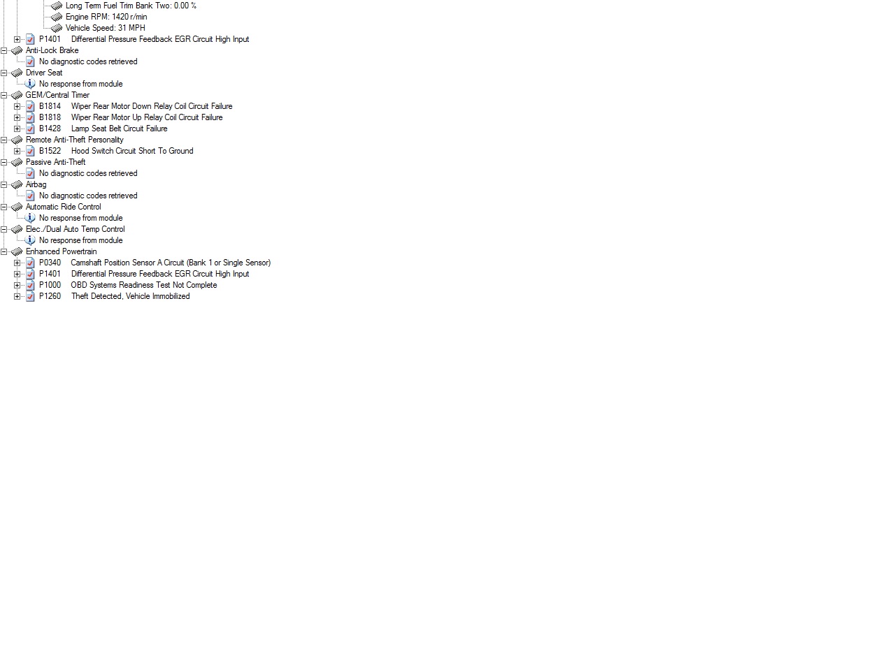

Got the DPSE replaced and re-ran my scan program. Got these, Alternator was running at 13.5 volts. I will replace that before the CPS I think.
Hi Ryan. Is the p0340 an active code? It may be the source of the high idle.

Yeah it is still active! Funny you should mention the coolant level as it was low. I filled it, but probably need to get some more. I only had about 1/2 gallon to put in. I will double check that here soon. As far as the lid goes, I can run up to the salvage yard here and get one, I just need to remember to put it on my list. I always go, then say what else do I need and it slips my mind.
