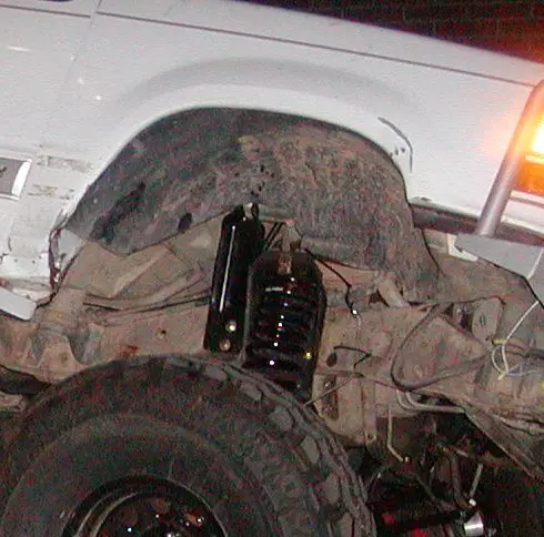

You can use the stock coil buckets IF you remove the tabs that stick down inside the stock coil springs AND you install something to retain the top of the coils in the bucket.
You can use a set of '99 F-250 2wd coil spring retainers. They are about $30 from a dealership.
Here is my coils with them installed, I am using RBV coils, but they will work the same with F-150 or early Bronco coils.

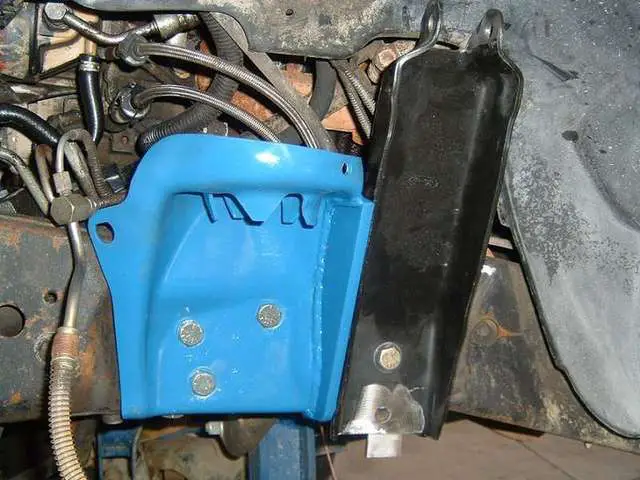

This is what I used for some time with the ttb.

There are other easier and cheaper ways to do use longer shocks.
Not really sure how your way is easier or cheaper. It's pretty much exactly how I'm doing this.
F250 shock towers for eyelet style shocks were $30 bucks for the pair
Coil buckets- available at the junkyard or $95 bucks online.
The early bronco coils may fit but the aftermarket buckets just seem to work much better.

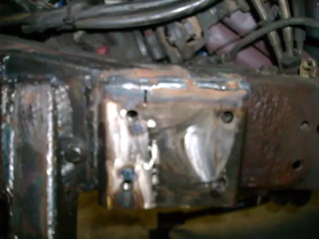

How did you modify it to fit the driver side frame rail? Do you have any pictures of that?

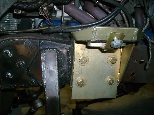

This is how i'm doing mine. The plate is 1/4" and was mainly added to give me a mounting point for my track bar and to reinforce the sector area. I cut out a piece of 2x6" 1/4" tubing and cut the back to fit the endention in the chassis. The front two bolts in the tower are fastened to the 2x6 with 1/2" bolts (grade 8) with the nuts welded on the inside. The back two run through the chassis and the 2x6, with spacers inside to keep the 2x6 from collapsing. The 2x6 is welded to the chassis. the axle is 2" forward any more than that and you will have to relocate the steering sector forward to compensate for the new steer angle. Also be awair of the location of the crossmember on the right side as it could interfear with the top right bolt placement.

That doesn't look too bad. How far out did you extend the bucket?

2" Which is pretty much standard on full width axles
I dont remember who but if you flip the spring pad around you dont have to space it. In that case you just notch the bucket to fit the frame.
